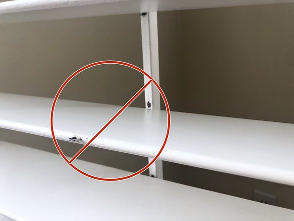

    • Locate the broken or loose louver.
