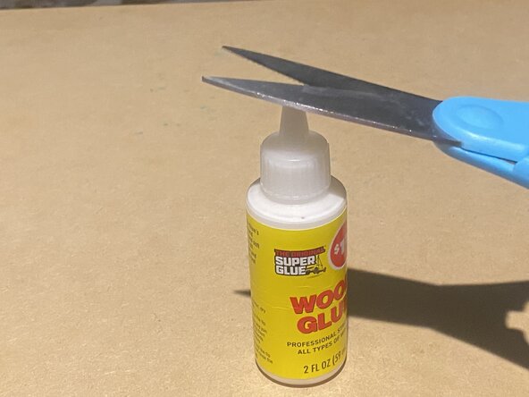

  3. How to Fix a Wobbling Living Room Table: 3 단계, 이미지 2개 중 1개 How to Fix a Wobbling Living Room Table: 3 단계, 이미지 2개 중 2개
    • Remove the cap from the wood glue.
    • Use scissors to cut open the tip so the glue is able to be squeezed out.

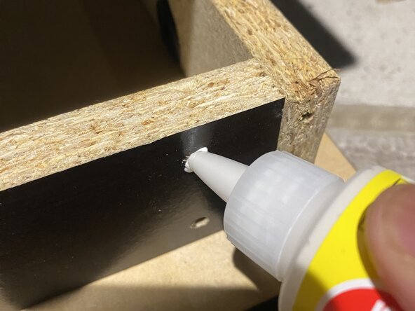

  4. How to Fix a Wobbling Living Room Table: 4 단계, 이미지 2개 중 1개 How to Fix a Wobbling Living Room Table: 4 단계, 이미지 2개 중 2개
    • Gently squeeze the wood glue into the screw holes.

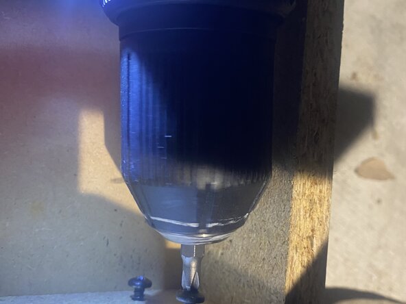

  6. How to Fix a Wobbling Living Room Table: 6 단계, 이미지 2개 중 1개 How to Fix a Wobbling Living Room Table: 6 단계, 이미지 2개 중 2개
    • Put all the screws back into their original holes. Then use the Phillips 6 screwdriver to tighten each screw.
    • For the back section, use a drill if the screw won't go in with the screwdriver.

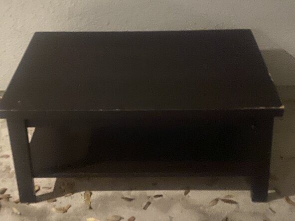

  7. How to Fix a Wobbling Living Room Table: 7 단계, 이미지 3개 중 1개 How to Fix a Wobbling Living Room Table: 7 단계, 이미지 3개 중 2개 How to Fix a Wobbling Living Room Table: 7 단계, 이미지 3개 중 3개
    • Place the table in a safe location and let it sit for at least 30 minutes.
    • After the time has passed, flip the table back onto its legs and gently shake it to make sure the glue has set.
결론

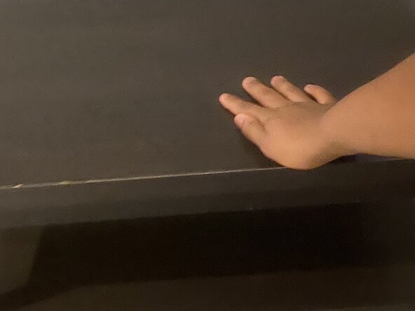

Once you have finished this guide, your table should no longer be slanted.
