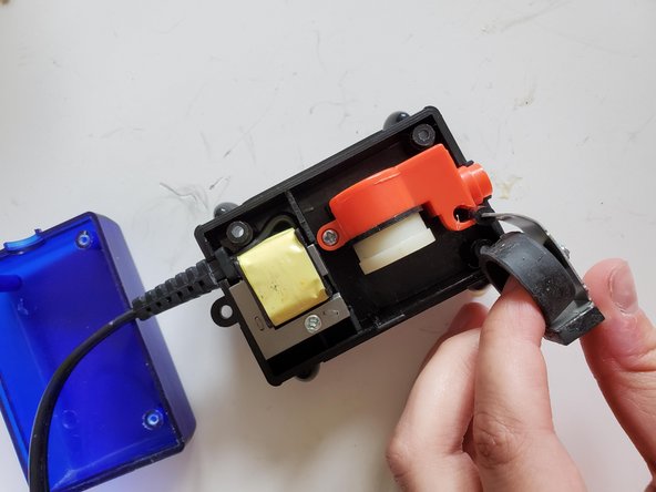

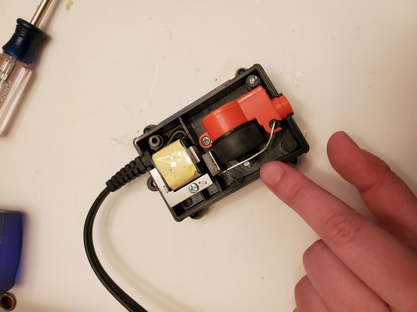

  3. How to Fix an Air Tech 2K0 Aquarium Pump: 3 단계, 이미지 1/3 How to Fix an Air Tech 2K0 Aquarium Pump: 3 단계, 이미지 2/3 How to Fix an Air Tech 2K0 Aquarium Pump: 3 단계, 이미지 3/3

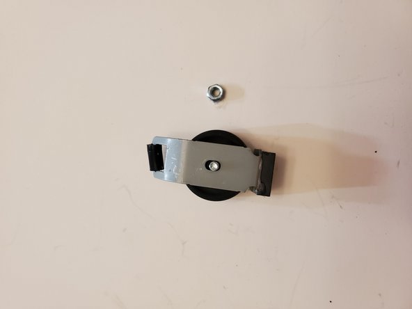

    • Remove the round, rubber cover called the diaphragm.
  4. How to Fix an Air Tech 2K0 Aquarium Pump: 4 단계, 이미지 1/3 How to Fix an Air Tech 2K0 Aquarium Pump: 4 단계, 이미지 2/3 How to Fix an Air Tech 2K0 Aquarium Pump: 4 단계, 이미지 3/3

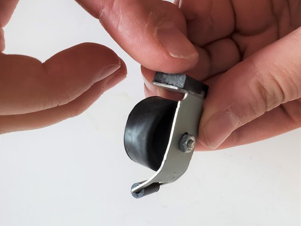

    • Once the entire piece is removed, unscrew the the rubber diaphragm from the metal part.
    • Begin by twisting off the washer.
    • From here, remove the metal piece and the screw (1.25mm x 8mm) from the center of the diaphragm.

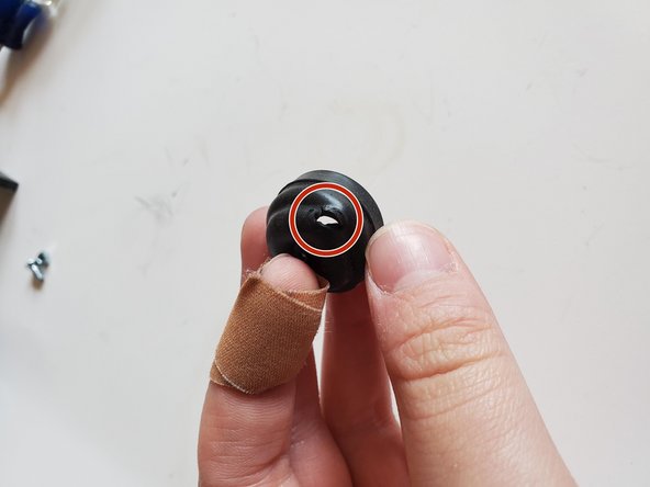

  5. How to Fix an Air Tech 2K0 Aquarium Pump: 5 단계, 이미지 1/3 How to Fix an Air Tech 2K0 Aquarium Pump: 5 단계, 이미지 2/3 How to Fix an Air Tech 2K0 Aquarium Pump: 5 단계, 이미지 3/3

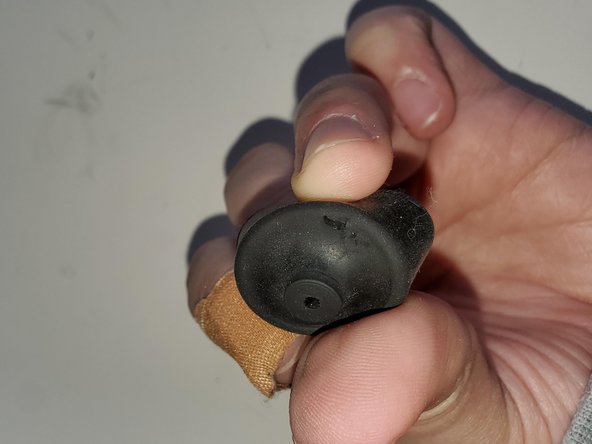

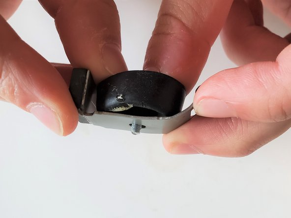

    • Once the diaphragm has been separated, set aside the metal piece, the screw (1.25mm x 8mm), and the washer.
    • Examine the diaphragm for damage.
    • Here, you can see a hole in the diaphragm that needs to be repaired.

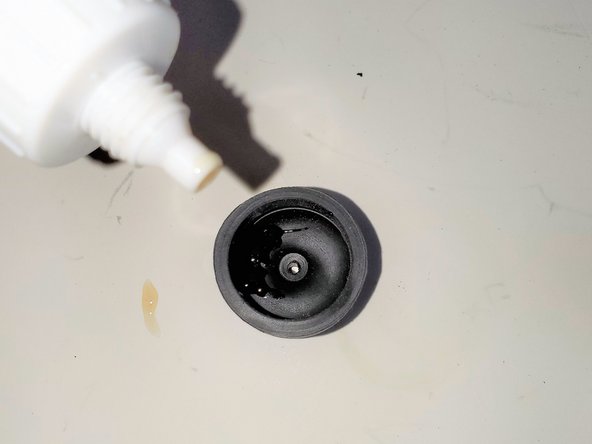

  6. How to Fix an Air Tech 2K0 Aquarium Pump: 6 단계, 이미지 1/3 How to Fix an Air Tech 2K0 Aquarium Pump: 6 단계, 이미지 2/3 How to Fix an Air Tech 2K0 Aquarium Pump: 6 단계, 이미지 3/3
    • Using the Gorilla Glue, coat the diaphragm on both the inside and outside of the damaged area to ensure adhesion.
    • Make sure the entire area is covered as pictured - it's okay if it looks messy.
  7. How to Fix an Air Tech 2K0 Aquarium Pump: 7 단계, 이미지 1/1
    • Allow the glue to dry thoroughly before reassembling the air pump.

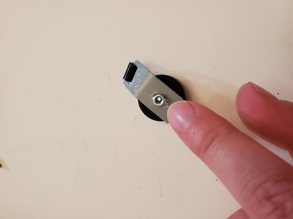

    • From here, follow Step 4 in reverse to reassemble the diaphragm and its attached metal piece:
    • Insert the screw (1.25mm x 8mm) through the hole of the diaphragm.
    • Place the metal piece flush against the back of the diaphragm, making sure to line up the screw with the hole.
    • Finally, screw the washer back on to ensure a secure fit between all the pieces.

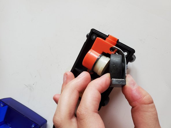

  9. How to Fix an Air Tech 2K0 Aquarium Pump: 9 단계, 이미지 1/2 How to Fix an Air Tech 2K0 Aquarium Pump: 9 단계, 이미지 2/2
    • Place the reassembled diaphragm back into the slot you initially removed it from.
