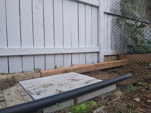

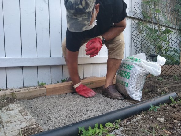

  3. How to Repair A Garden Walkway With Concrete Slabs: 3 단계, 이미지 3개 중 1개 How to Repair A Garden Walkway With Concrete Slabs: 3 단계, 이미지 3개 중 2개 How to Repair A Garden Walkway With Concrete Slabs: 3 단계, 이미지 3개 중 3개
    • Apply the first layer of limestone screening mixture, making sure it is even around the area.
    • Insert the first slab tile.

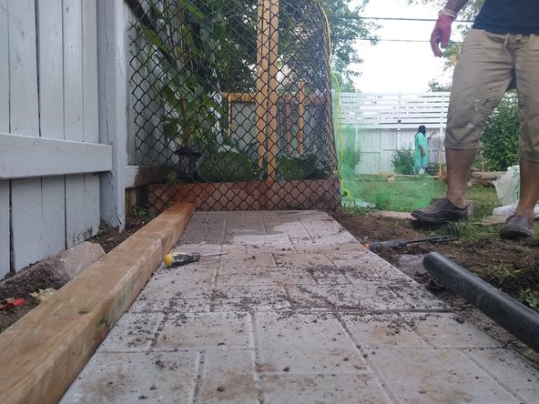

  4. How to Repair A Garden Walkway With Concrete Slabs: 4 단계, 이미지 2개 중 1개 How to Repair A Garden Walkway With Concrete Slabs: 4 단계, 이미지 2개 중 2개
    • Apply some more of the mixture and then insert the second slab tile.
  5. How to Repair A Garden Walkway With Concrete Slabs: 5 단계, 이미지 2개 중 1개 How to Repair A Garden Walkway With Concrete Slabs: 5 단계, 이미지 2개 중 2개
    • Apply third and final slab.
    • If needed, add some extra soil or the limestone screening mixture to make it even with the other two slab tiles.

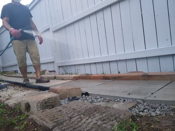

  7. How to Repair A Garden Walkway With Concrete Slabs: 7 단계, 이미지 3개 중 1개 How to Repair A Garden Walkway With Concrete Slabs: 7 단계, 이미지 3개 중 2개 How to Repair A Garden Walkway With Concrete Slabs: 7 단계, 이미지 3개 중 3개
    • Clean off the excess debris with your good ol' broom and wash it off with the garden hose to make it nice and shiny.
