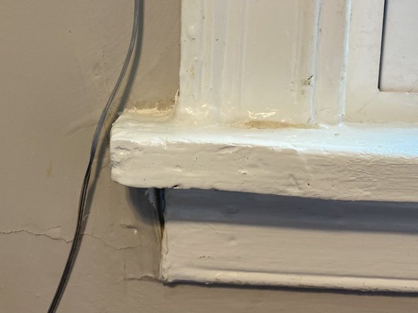

    • Remove any loose, splintered, or jagged wood by hand.
