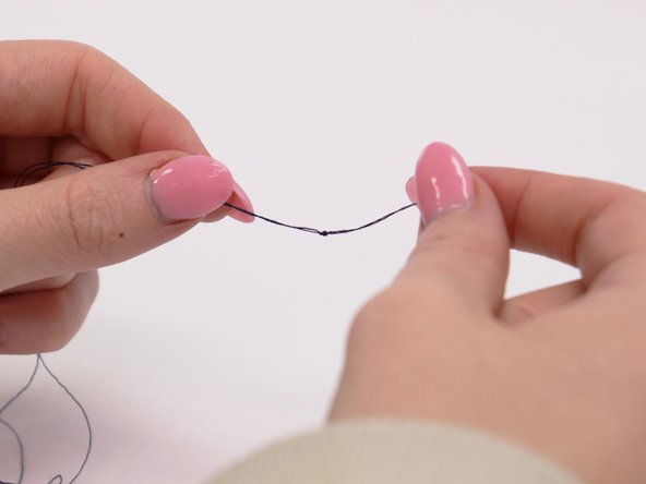

  6. How to Replace a Broken Lanyard Clasp: 6 단계, 이미지 3개 중 1개 How to Replace a Broken Lanyard Clasp: 6 단계, 이미지 3개 중 2개 How to Replace a Broken Lanyard Clasp: 6 단계, 이미지 3개 중 3개
    • With the lower part of the thread, cross both sides over each other.
    • Tie the two sides together, making sure the knot stays towards the bottom of the thread.

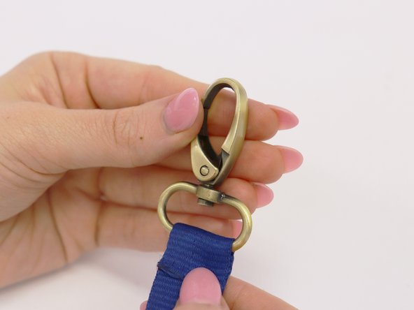

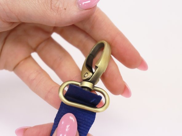

  7. How to Replace a Broken Lanyard Clasp: 7 단계, 이미지 3개 중 1개 How to Replace a Broken Lanyard Clasp: 7 단계, 이미지 3개 중 2개 How to Replace a Broken Lanyard Clasp: 7 단계, 이미지 3개 중 3개
    • Line up both sides of the lanyard.
    • Place the joined ends through the bottom of the new clasp.
    • Fold the lanyard over the bottom of the clasp.
    • Different lanyards may be configured differently. Follow the previous fold lines on your lanyard to best note how to rejoin the ends.

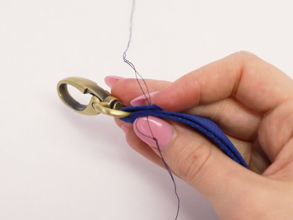

  8. How to Replace a Broken Lanyard Clasp: 8 단계, 이미지 2개 중 1개 How to Replace a Broken Lanyard Clasp: 8 단계, 이미지 2개 중 2개
    • Take the threaded needle and poke it through on one side of the lanyard.
    • Pull the needle and thread all the way through until the knot catches on the underside of the lanyard.
    • Make sure your needle goes through all the layers of the lanyard, paying particular attention to include the folded part.
