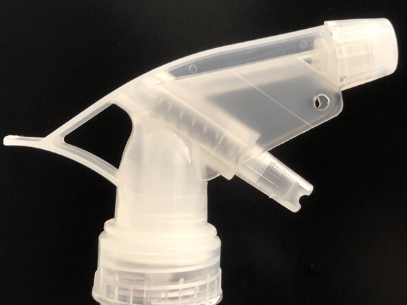

  1. How to Replace the Trigger Spring of a Spray Bottle, Trigger Spring: 1 단계, 이미지 3개 중 1개 How to Replace the Trigger Spring of a Spray Bottle, Trigger Spring: 1 단계, 이미지 3개 중 2개 How to Replace the Trigger Spring of a Spray Bottle, Trigger Spring: 1 단계, 이미지 3개 중 3개
    • Slightly and gently spread the plastic head so you can easily slide out the trigger lever to access the remaining parts.
    • Be careful not to push too hard when holding the plastic open to avoid finger injury or product breakage.

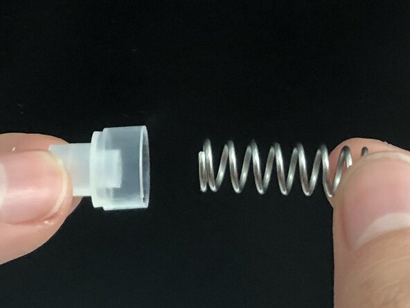

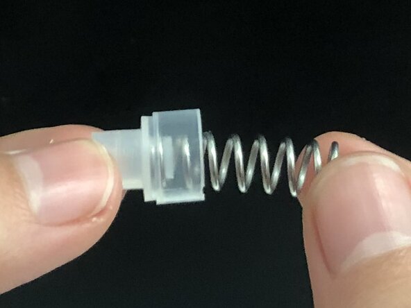

  2. How to Replace the Trigger Spring of a Spray Bottle: 2 단계, 이미지 3개 중 1개 How to Replace the Trigger Spring of a Spray Bottle: 2 단계, 이미지 3개 중 2개 How to Replace the Trigger Spring of a Spray Bottle: 2 단계, 이미지 3개 중 3개
    • After separating the trigger lever from the rest of the bottle, place the spring into the opening slot.
    • You can alternatively start by connecting the larger opening of the smaller plastic part with the spring.
  3. How to Replace the Trigger Spring of a Spray Bottle: 3 단계, 이미지 2개 중 1개 How to Replace the Trigger Spring of a Spray Bottle: 3 단계, 이미지 2개 중 2개
    • Gently but firmly push in the smaller plastic slot.
