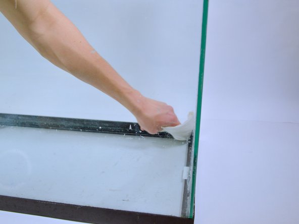

    • Get the razor blade underneath the seal, and scrape from the top to the bottom, with long and steady cuts to remove the sealant.
    • Do not insert the blade in-between the panels because that can separate the glass.

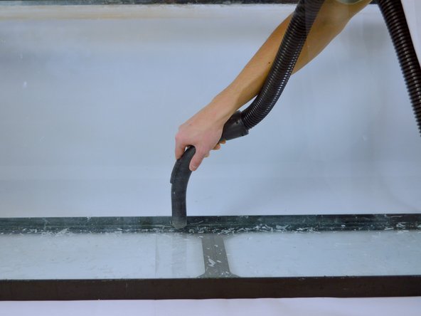

    • Remove the remaining silicone with paper towels, acetone, and a vacuum.
    • Apply acetone until you do not feel any sticky residue (silicone).
    • If the silicone does not come off with the acetone, use razor blades to assist in any final removal.
    • The new silicone will not bond unless all of the old silicone is removed.

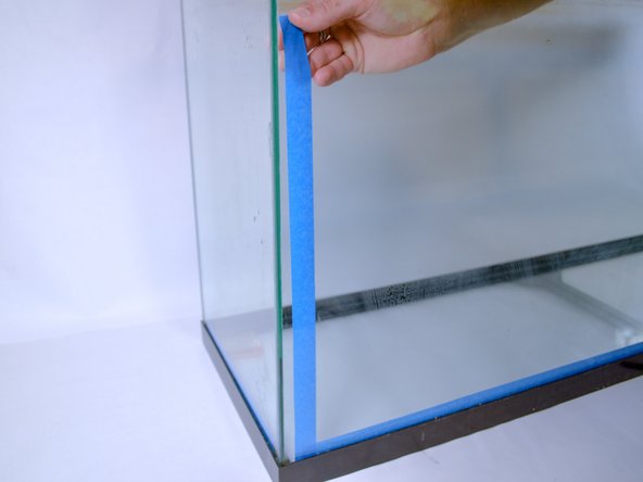

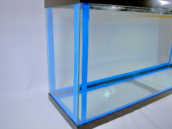

    • Apply tape along the interior edges of the tank.
    • Leave a gap between the interior corners and the lines of tape.
    • The gap should be approximately 1/2 inch.

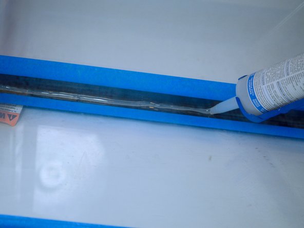

    • Cut the tip of the silicone at the three-eighths mark.
    • Press the caulking gun to apply an even bead ¼” bead of silicone along the corners.
    • Apply it quickly because the silicone dries within minutes.
    • Consider where the original leak was and apply extra silicone as needed.
