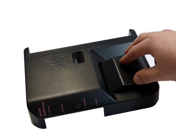

  4. How to repair the foot pedal (spring): 4 단계, 이미지 3개 중 1개 How to repair the foot pedal (spring): 4 단계, 이미지 3개 중 2개 How to repair the foot pedal (spring): 4 단계, 이미지 3개 중 3개
    • Push the rod out by using the screwdriver as a lever.
    • Pull out the rod with the wrench on the other side.

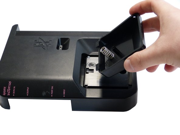

  5. How to repair the foot pedal (spring): 5 단계, 이미지 3개 중 1개 How to repair the foot pedal (spring): 5 단계, 이미지 3개 중 2개 How to repair the foot pedal (spring): 5 단계, 이미지 3개 중 3개
    • Turn around the upper casing.
    • Grab the pedal and pull it out of the casing.
  6. How to repair the foot pedal (spring): 6 단계, 이미지 3개 중 1개 How to repair the foot pedal (spring): 6 단계, 이미지 3개 중 2개 How to repair the foot pedal (spring): 6 단계, 이미지 3개 중 3개
    • Push the spring back in position on the ring.
    • Put the pedal back in the casing.
  7. How to repair the foot pedal (spring): 7 단계, 이미지 1개 중 1개
    • Push the rod back in position.
결론
Close the casing again and fasten the casing with the screws. You have now successfully replaced the spring!
