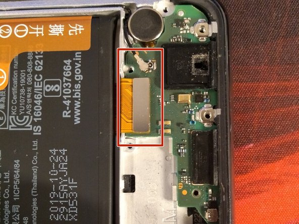

  5. Huawei Honor 9X Screen Replacement, Remove the Bottom Assembly: 5 단계, 이미지 3개 중 1개 Huawei Honor 9X Screen Replacement, Remove the Bottom Assembly: 5 단계, 이미지 3개 중 2개 Huawei Honor 9X Screen Replacement, Remove the Bottom Assembly: 5 단계, 이미지 3개 중 3개
    • Remove the 6 screws holding the speaker and the circuit cover marked in the first picture
    • Remove the speaker and the plastic cover
    • Disconnect the flexes going to the motherboard marked in the second image
    • Remove the circuit board and the vibromotor
  6. Huawei Honor 9X Screen Replacement, Remove the Battery: 6 단계, 이미지 3개 중 1개 Huawei Honor 9X Screen Replacement, Remove the Battery: 6 단계, 이미지 3개 중 2개 Huawei Honor 9X Screen Replacement, Remove the Battery: 6 단계, 이미지 3개 중 3개
    • Follow the markers on the film attached to the battery to unfold the film and remove the battery
    • You may need to use some force to detach the battery by pulling the film out of the smartphone
    • Do not use any charp tools to not damage the battery!
    • Detach the film covering the flexes
    • Remove the flexes connecting the motherbord and the bottom circuit board
