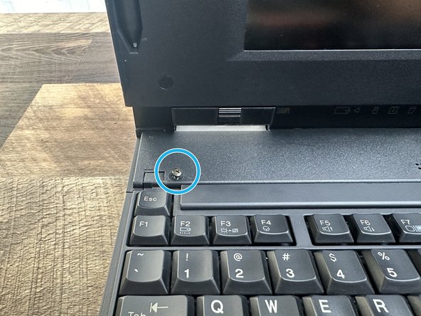

    • Remove the two (2) plastic screw covers from the keyboard cover using a thin tool. If you use a hobby knife or a blade, be sure not to cut or damage the screw covers.
    • Remove the two (2) M2.5x8mm screws from underneath the covers with a Philips head driver.

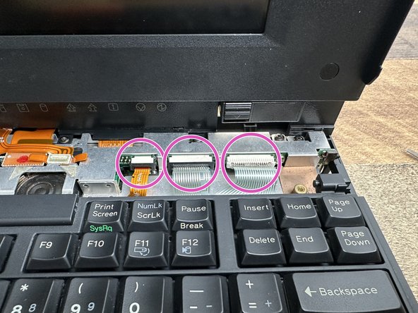

    • Remove the three (3) keyboard ribbon cables by unclipping them from the connectors. Do this by using a plastic spudger or pair of tweezers by pulling each side of the clip towards you. Once loosened you can pull the ribbon cable out.
    • Be careful not to damage or scratch the ribbon cables, they are incredibly delicate.
    • You can now remove the keyboard and set it aside.

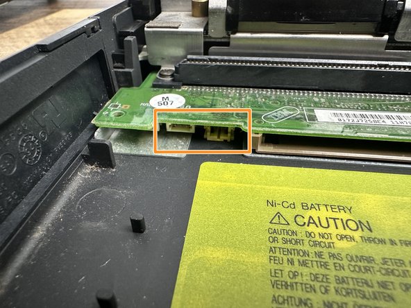

    • There may be one (1) or two (2) batteries plugged on the underside of the board. Disconnect and remove them before continuing.

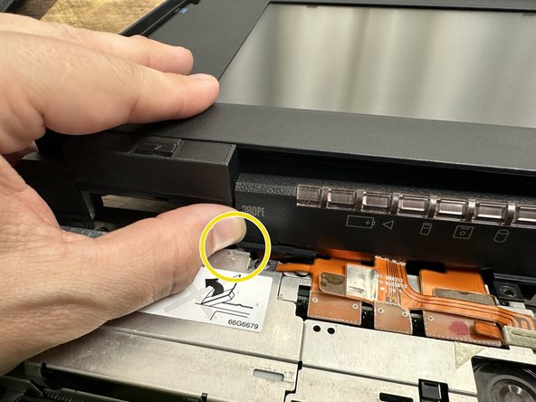

    • Remove the two (2) highlighted connectors first. You can use the tabs connected to the ribbon cables, but do NOT pull on the cables themselves. Each cable has a hard plastic stiffener attached that can be used to lever the cables out if the tabs are damaged or missing.
    • Remove the second set of cables AND the single (1) M2.5x5mm Philips screw that connects one of the cables to the shield.

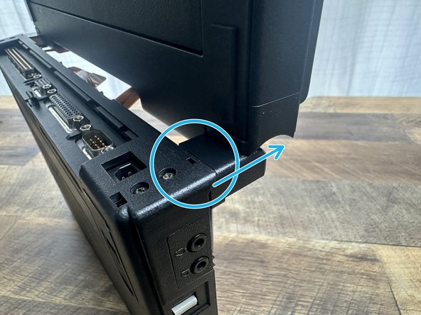

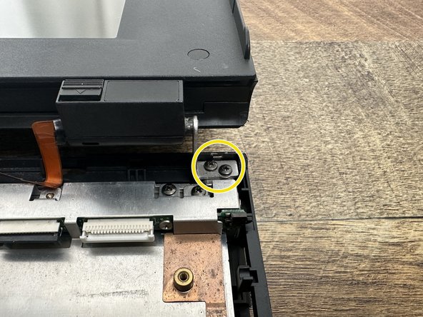

    • Using a pair of tweezers or plastic spudger, release the clip on the back to remove the hinge covers on both sides.
    • Remove the two (2) M2.5x4mm screws connecting the display to the case on both sides.

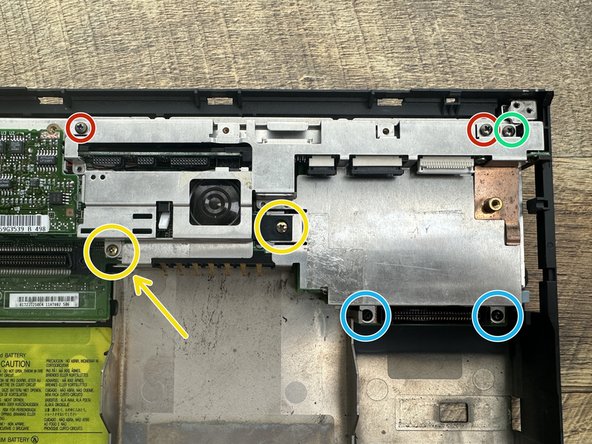

  8. IBM ThinkPad 360P/PE Disassembly, Remove the Main Shield: 9 단계, 이미지 3개 중 1개 IBM ThinkPad 360P/PE Disassembly, Remove the Main Shield: 9 단계, 이미지 3개 중 2개 IBM ThinkPad 360P/PE Disassembly, Remove the Main Shield: 9 단계, 이미지 3개 중 3개
    • First, use a plastic pick to remove the plastic battery shield being careful not to tear the plastic.
    • Remove the two (2) M2.5x4mm Philips screws from the top where indicated.
    • Remove the single (1) M2.5x3mm Philips screw where indicated.
    • Remove the two (2) M2.5x16mm Philips screws from the bottom left by the battery. When removing the left screw (indicated by the arrow) make sure to save the plastic spacer underneath.
    • Remove the two (2) M2.5x6mm Philips screws from the bottom right securing the HDD connector.
    • Use caution when removing the shield as the speaker cable will still be connected.
    • Disconnect the speaker cable from the Audio Board. You can then remove the Main Shield and set aside.

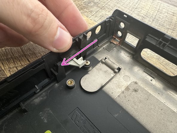

    • To remove the main board, carefuly lift up the back and move towards the front of the case. There are two areas, one on each side that you'll need to be careful to clear.
    • Reassembly Tip: Make sure the power slide is all the way toward the case when reassembling. The switch on the main board should rest in the notch inside the white arm of the slide.

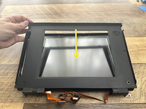

  14. IBM ThinkPad 360P/PE Disassembly, Remove the Panel: 15 단계, 이미지 2개 중 1개 IBM ThinkPad 360P/PE Disassembly, Remove the Panel: 15 단계, 이미지 2개 중 2개

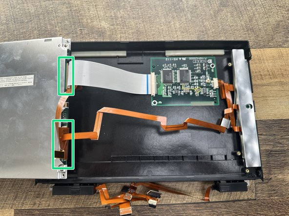

    • Disconnect the power cable to the LCD from the inverter board.
    • Remove the single (1) M2x7mm Philips head screw and washer where indicated.
    • Fold out the LCD panel being careful not to damage the two (2) ribbon cables connected on the underside of the left side of the panel.
    • Disconnect the two (2) ribbon cables from the rear of the LCD panel. Remove and set aside.
