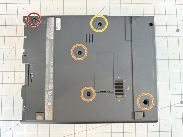

  3. IBM ThinkPad 701C/CS Disassembly, Remove the keyboard screws: 3 단계, 이미지 3개 중 1개 IBM ThinkPad 701C/CS Disassembly, Remove the keyboard screws: 3 단계, 이미지 3개 중 2개 IBM ThinkPad 701C/CS Disassembly, Remove the keyboard screws: 3 단계, 이미지 3개 중 3개
    • Remove the PCMCIA cover by pushing out on the top edge and rotating downward to release the hard drive.
    • Remove the Hard disk drive by sliding the unlock button and pushing it out. The HDD should be removed after the Battery and the PCMCIA cover to avoid damage to the plastic clips.
    • These laptops are notorious for the rubber paint liquifying over time. This may be dificult to do, but be careful to not break the case plastics or the plastic drive harness.
    • Flip the laptop over so the screen hinge is facing away from you. Remove the 8mm (BH) screw at the top left with a T6 Torx bit.
    • Remove the three (3) 6mm (BC) screws from the middle and bottom right with a T6 Torx bit.
    • Remove the 10mm (BE) screw from the top center with a T6 Torx bit.
    • Remove the four (4) 3mm (BF) screws freom the front of the lowe case using a T1 Torx bit.
    • These T1 screws are fragile. Don't lose them and do NOT try to use any other type of driver to remove them. They can be easily stripped.

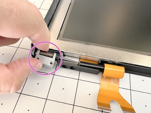

  10. IBM ThinkPad 701C/CS Disassembly, Remove display housing: 10 단계, 이미지 2개 중 1개 IBM ThinkPad 701C/CS Disassembly, Remove display housing: 10 단계, 이미지 2개 중 2개
    • The inner frame is thin and may be brittle, be careful when removing!
    • Remove the four (4) 8.4mm (BD) screws from the inside frame using a T6 Torx bit.
    • Remove the two (2) 8mm (BH) screws from the bottom left display bracket using a T6 Torx bit.
    • Remove the two (2) 5mm (BI) screws from the bottom right display bracket using a T6 Torx bit.
    • Lift off the left hinge cover before proceeding to the next step.
  11. IBM ThinkPad 701C/CS Disassembly, Remove display housing Contd.: 11 단계, 이미지 3개 중 1개 IBM ThinkPad 701C/CS Disassembly, Remove display housing Contd.: 11 단계, 이미지 3개 중 2개 IBM ThinkPad 701C/CS Disassembly, Remove display housing Contd.: 11 단계, 이미지 3개 중 3개
    이 단계에 사용된 도구:
    • Use a plastic pick to unclip the T-shaped snaps along the sides of the bezel.
    • The top of the bezel may be glued to the frame. Carefully dislodge the bezel from the glue before lifting the frame out and away.
    • After removing the bezel, you can remove the display hinges by lifting them up and out.
    • The display should now come away freely from the frame.

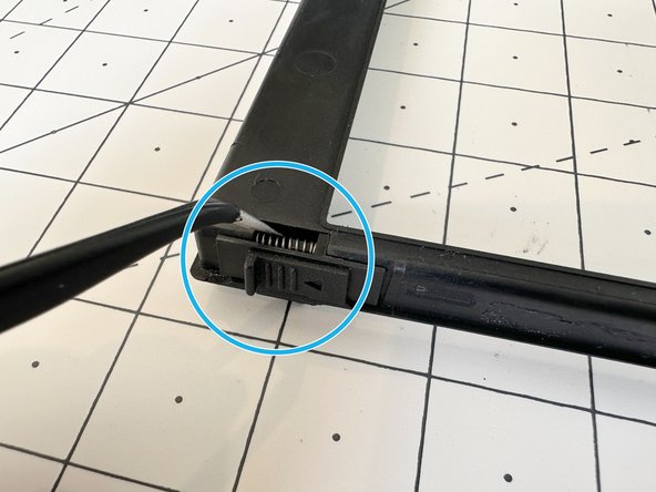

    • If needed, you can remove the display latches from the back of the bezel by using a pair of tweezers to squeeze the springs. The latches sould pop out.
