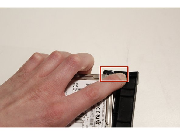

  2. IBM ThinkPad R40 Hard Drive Replacement, Remove the hard drive holder.: 2 단계, 이미지 2개 중 1개 IBM ThinkPad R40 Hard Drive Replacement, Remove the hard drive holder.: 2 단계, 이미지 2개 중 2개
    • Remove the Phillips #1 screw from the bottom of the laptop.
    • Pull on the small rise in the plastic to remove the hard drive holder.
    • Don't be afraid to use some force, it requires quite a bit of pressure to remove.
  3. IBM ThinkPad R40 Hard Drive Replacement, Remove the hard drive holder.: 3 단계, 이미지 3개 중 1개 IBM ThinkPad R40 Hard Drive Replacement, Remove the hard drive holder.: 3 단계, 이미지 3개 중 2개 IBM ThinkPad R40 Hard Drive Replacement, Remove the hard drive holder.: 3 단계, 이미지 3개 중 3개
    • Remove the hard drive holder completely from the computer.
    • Push on the plastic, and the hard drive will pop out.
  4. IBM ThinkPad R40 Hard Drive Replacement, Remove the hard drive.: 4 단계, 이미지 1개 중 1개
    • Remove the four Phillips #1 screws.
