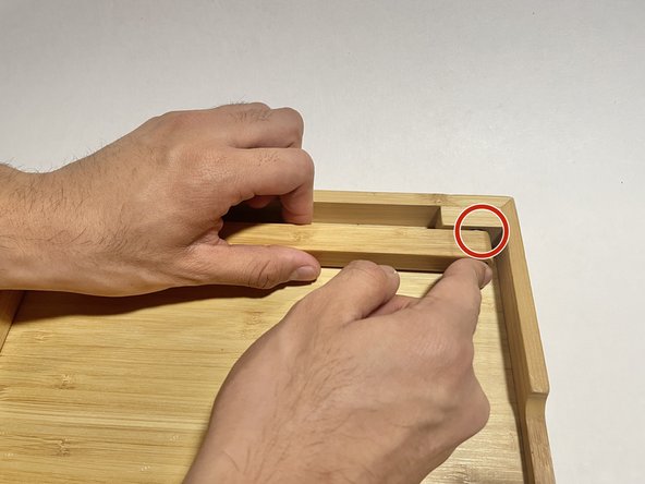

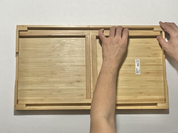

    • Carefully place the bed tray face down on an even surface.
    • Avoid working on a table or surface that you wouldn't want to get scratched. While the repair is safe, you could inadvertently scratch the tabletop.
  2. Ikea RESGODS Bed Tray Leg Replacement: 2 단계, 이미지 1/2 Ikea RESGODS Bed Tray Leg Replacement: 2 단계, 이미지 2/2

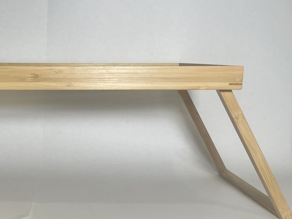

    • Identify which screw is loose or which leg is detached.
    • Lift the bed tray leg by two millimeters.

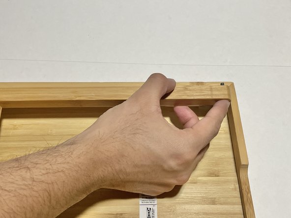

  3. Ikea RESGODS Bed Tray Leg Replacement: 3 단계, 이미지 1/3 Ikea RESGODS Bed Tray Leg Replacement: 3 단계, 이미지 2/3 Ikea RESGODS Bed Tray Leg Replacement: 3 단계, 이미지 3/3
    • Insert the 1/2 inch truss head screw inside the leg hole.

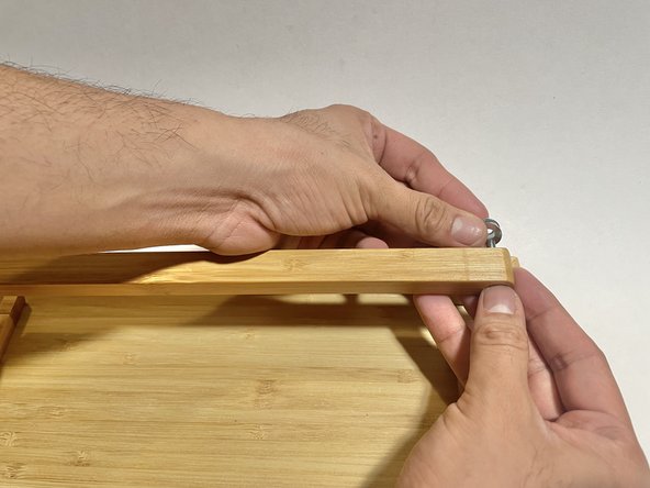

  4. Ikea RESGODS Bed Tray Leg Replacement: 4 단계, 이미지 1/3 Ikea RESGODS Bed Tray Leg Replacement: 4 단계, 이미지 2/3 Ikea RESGODS Bed Tray Leg Replacement: 4 단계, 이미지 3/3
    • Slide two steel flat washers onto the screw.
  5. Ikea RESGODS Bed Tray Leg Replacement: 5 단계, 이미지 1/3 Ikea RESGODS Bed Tray Leg Replacement: 5 단계, 이미지 2/3 Ikea RESGODS Bed Tray Leg Replacement: 5 단계, 이미지 3/3
    • Attach the leg to the hole with the screw and steel flat washers.
  6. Ikea RESGODS Bed Tray Leg Replacement: 6 단계, 이미지 1/3 Ikea RESGODS Bed Tray Leg Replacement: 6 단계, 이미지 2/3 Ikea RESGODS Bed Tray Leg Replacement: 6 단계, 이미지 3/3
    • Use a Phillips #00 screwdriver to secure the screw to the tray.
