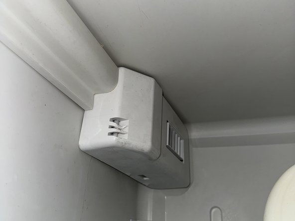

    • Locate the air diffuser inside your fridge.

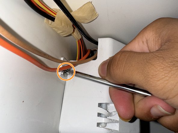

  4. Kenmore Coldspot Fridge Air Diffuser Replacement: 4 단계, 이미지 2개 중 1개 Kenmore Coldspot Fridge Air Diffuser Replacement: 4 단계, 이미지 2개 중 2개
    • Remove the first screw securing the diffuser in place.
    • Remove the second screw that is holding the air diffuser in place.

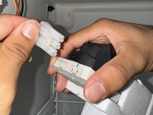

  6. Kenmore Coldspot Fridge Air Diffuser Replacement: 6 단계, 이미지 2개 중 1개 Kenmore Coldspot Fridge Air Diffuser Replacement: 6 단계, 이미지 2개 중 2개
    • Disconnect the wiring in the fridge that is connected to the old air diffuser.
