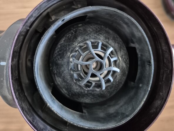

    • Unscrew the silver cone located inside the waste container. Watch some youtube videas first as there a special way this is done otherwise it might break using one of the vacuum nozzles.
    • The cone appears to be quite brittle, and from what I’ve seen, you're meant to use one of the vacuum’s nozzle attachments to safely remove it. I managed to unscrew it by hand, but be cautious—it feels fragile and could easily crack under pressure.
    • Important: Surprisingly, the silver cone plays a structural role—it actually presses the motor base into position. When you remove the screws in the next step, you're unscrewing them from the motor base plate, which is held firmly in place by the cone.
    • Keep this in mind during reassembly: If you don’t reinstall the cone first, the screws won’t align properly with the motor base plate. The cone is essential for holding the motor base in position, so make sure it’s seated correctly before driving the screws back in.

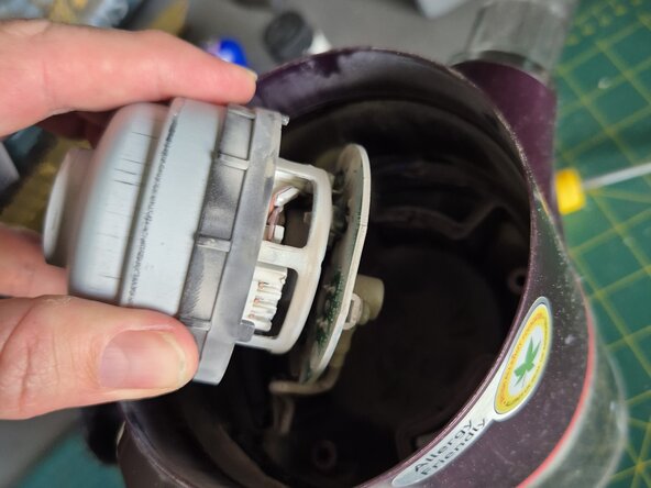

    • Carefully remove the plastic motor cover, which secures the motor in place. You'll need to unscrew 3 or 4 fasteners—take note of their positions for reassembly. Once the screws are out, the motor should come free and drop down gently.
    • Be aware that it's still connected to wiring that leads to the control switches and battery power supply, so avoid pulling or straining the cables.
    • Dont remove wiring yet. Dust off the wiring. There should be a black and a white wires. The black goes to GND (ground). Make a note where exactly the wires go and take photos including the small delicate control harness (it will go in a different place on the new motor)
    • As shown in the picture. You can obtain the part number of the motor assembly from the side rof the motor casing. Mine was Part Number EAU63543703.
    • Finding the right part number. If you google the motor part number As shown in the picture. You can obtain the part number of the motor assembly from the side rof the motor casing. Mine was Part Number EAU63543703 you should get a hit on the LG spare parts website.
    • However, you will most likely find the part number you have is superseded by a different LG part number. This is when you need to look up the replacement part number that the LG website recommends and check that it is compatcble with your LG vacuum model number (the number that was in the battery compartment). Mine was A9PRO.
    • The replacement part number for mine was: EAU64483704 LG CORDZERO A9 STICK VACUUM MOTOR. Look under product details on the LG webpage for you model number to verify.
