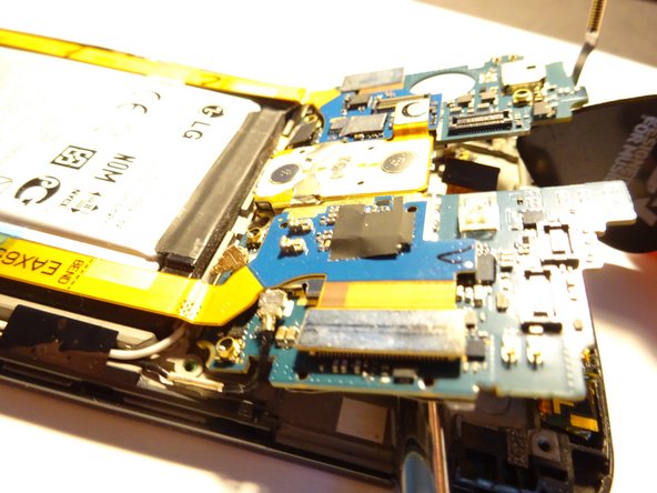

  8. LG G2 Rear Camera Replacement, Gently tilt up motherboard, careful to watch 4x flex cables: 8 단계, 이미지 2개 중 1개 LG G2 Rear Camera Replacement, Gently tilt up motherboard, careful to watch 4x flex cables: 8 단계, 이미지 2개 중 2개
    • Using spudger/guitar pick/fingers, gently tilt the top of the motherboard up.
    • Watch out! Be careful to ensure the 4x flex cables that you see in the photo clear the motherboard - flip them up so they don't catch and tear. 3x come from the top edge, 1x is next to the camera module.

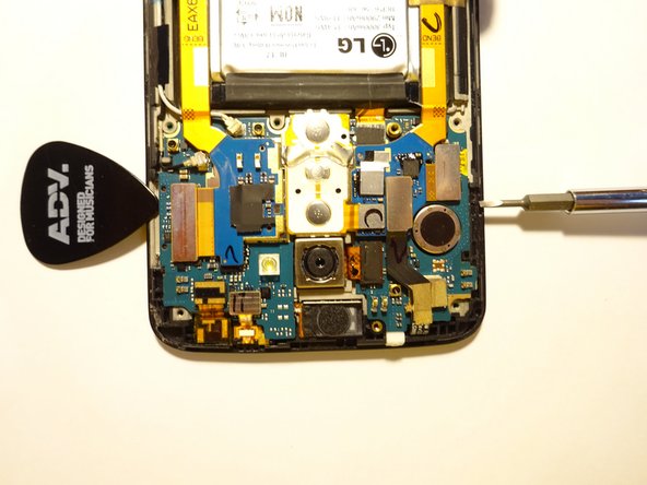

  9. LG G2 Rear Camera Replacement, Remove broken camera module, replace.: 9 단계, 이미지 1개 중 1개
    • Here, you can use a flat head screwdriver to pry up as shown. No need to worry about breaking the camera flex cable since it is broken. (If you are salvaging from another G2, you'll want to be careful, use a plastic spudger if desired, gently insert and lift. Once the module is tilted a bit, breaking the tape under, you can pull it out by hand.
    • You will want to keep the top of the camera clean of dust. Same with the back, inside of the camera cover. No dust, better photos. Use an electronics duster spray as needed - be gentle with the camera module.
    • Make sure the 4 flex cables clear the motherboard when reassembling. Gently align,then press down to click each in place.
