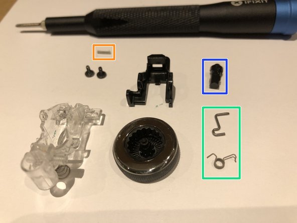

  4. Logitech VX Nano mouse wheel replacement, disassemble the mouse wheel: 4 단계, 이미지 2개 중 1개 Logitech VX Nano mouse wheel replacement, disassemble the mouse wheel: 4 단계, 이미지 2개 중 2개
    • Carefully loosen the two screws (only one can be seen in the picture, the other is directly opposite) with PH00.
    • This small spring is on the closed side of the mouse wheel and is used for "mobility" between the transparent and black plastic part.
    • This spring mechanism is used to "catch" the mouse wheel. When closed, the spring clicks on the internal teeth of the mouse wheel, while when open it has no contact points.
    • This part must be installed with the nose pointing upwards in the appropriate opening in the transparent cage and works in a similar way to a ballpoint pen's refill.
