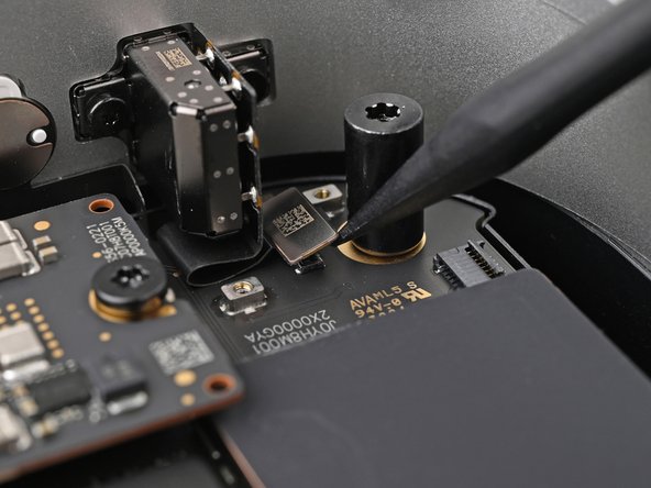

  25. Mac mini (2024) Headphone Jack Replacement, Disconnect the headphone jack: 25 단계, 이미지 2개 중 1개 Mac mini (2024) Headphone Jack Replacement, Disconnect the headphone jack: 25 단계, 이미지 2개 중 2개
    • Use the point of a spudger to pry up and disconnect the headphone jack press connector.

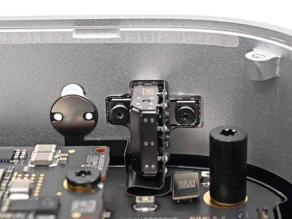

  27. Mac mini (2024) Headphone Jack Replacement, Apply isopropyl alcohol: 27 단계, 이미지 1개 중 1개
    • The power indicator light is connected to the headphone jack and requires separating its adhesive to continue.
    • Apply a few drops of isopropyl alcohol (>90%) to the top of the power indicator's silver plate.
    • Wait one minute for the alcohol to flow behind the power indicator and for the adhesive to loosen.
  28. Mac mini (2024) Headphone Jack Replacement, Separate the power indicator: 28 단계, 이미지 2개 중 1개 Mac mini (2024) Headphone Jack Replacement, Separate the power indicator: 28 단계, 이미지 2개 중 2개
    이 단계에 사용된 도구:
    Tesa 61395 Tape
    $5.99
    • Slide a Jimmy between the top of the power indicator and the chassis to separate the adhesive.
    • During reassembly, align the power indicator's holes over the white pegs in the chassis. If the old adhesive isn't sticky anymore, use a thin double-sided tape like Tesa Tape to replace it.
  29. Mac mini (2024) Headphone Jack Replacement: 29 단계, 이미지 2개 중 1개 Mac mini (2024) Headphone Jack Replacement: 29 단계, 이미지 2개 중 2개
    • Lightly grip the power indicator with tweezers and pull it away from the chassis to separate the adhesive securing its cable.

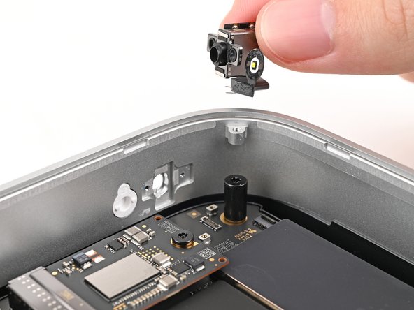

  30. Mac mini (2024) Headphone Jack Replacement, Remove the headphone jack: 30 단계, 이미지 2개 중 1개 Mac mini (2024) Headphone Jack Replacement, Remove the headphone jack: 30 단계, 이미지 2개 중 2개
    • Lift the headphone jack out of the chassis and remove it.
