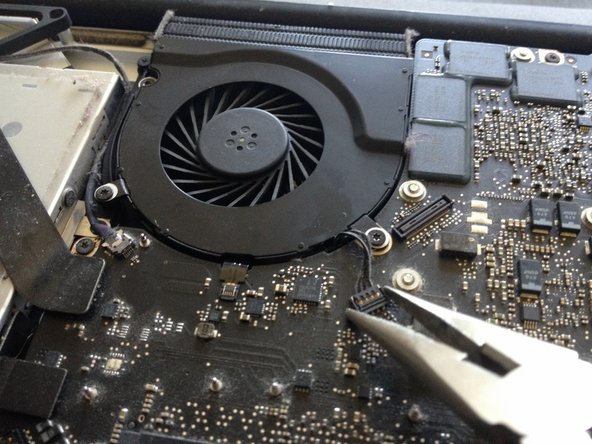

  7. MacBook Pro 17" Unibody  fixing noise fan and overheat, Disconnect the fan: 7 단계, 이미지 3개 중 1개 MacBook Pro 17" Unibody  fixing noise fan and overheat, Disconnect the fan: 7 단계, 이미지 3개 중 2개 MacBook Pro 17" Unibody  fixing noise fan and overheat, Disconnect the fan: 7 단계, 이미지 3개 중 3개
    • Disconnect the fan from the mainboard.
  8. MacBook Pro 17" Unibody  fixing noise fan and overheat, Almost there !: 8 단계, 이미지 1개 중 1개
    • Remove the 3 screws that fron the fan fixture.
  9. MacBook Pro 17" Unibody  fixing noise fan and overheat, Take a walk on the wild side !: 9 단계, 이미지 1개 중 1개
    • Clean the dust with a very soft toilet paper.
  10. MacBook Pro 17" Unibody  fixing noise fan and overheat, Finally!: 10 단계, 이미지 1개 중 1개
    • This is what I´ve found inside one fan !
