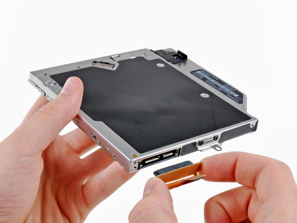

  13. MacBook Pro 17" Unibody Optical Drive Cable Replacement, Optical Drive Cable: 13 단계, 이미지 2개 중 1개 MacBook Pro 17" Unibody Optical Drive Cable Replacement, Optical Drive Cable: 13 단계, 이미지 2개 중 2개
    • Grab the optical drive cable by its connector and pull it away from the body of the optical drive.
    • Pulling on anything other than the optical drive connector may damage the optical drive cable.
