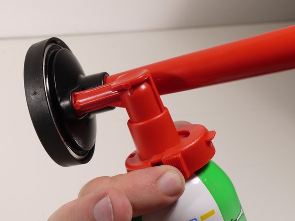

    • Take the new bottle and remove the cap.
  6. Marco TA1 Gas Bottle Replacement, Open the lock: 6 단계, 이미지 2개 중 1개 Marco TA1 Gas Bottle Replacement, Open the lock: 6 단계, 이미지 2개 중 2개
    • Open the lock on the trumpet.
  7. Marco TA1 Gas Bottle Replacement, Put the trumpet on the bottle: 7 단계, 이미지 2개 중 1개 Marco TA1 Gas Bottle Replacement, Put the trumpet on the bottle: 7 단계, 이미지 2개 중 2개
    • Put the trumpet on the bottle.
    • BE CAREFUL. Keep your fingers away from the trumpet and red circled moving parts: when the trumpet is on the gas bottle and you press it, it will honk!!
  8. Marco TA1 Gas Bottle Replacement, Close the lock on the bottle: 8 단계, 이미지 2개 중 1개 Marco TA1 Gas Bottle Replacement, Close the lock on the bottle: 8 단계, 이미지 2개 중 2개
    • BE CAREFUL. The horn may honk if you press it too strong on the red marked part.
  9. Marco TA1 Gas Bottle Replacement, Check that the lock it's completely sealed: 9 단계, 이미지 2개 중 1개 Marco TA1 Gas Bottle Replacement, Check that the lock it's completely sealed: 9 단계, 이미지 2개 중 2개
    • The red circled lock has to be like in the picture, out and up. If it's still inside, the trumpet may disconnect.
    • The blue circled part should be like in the picture, with no space between the components.
