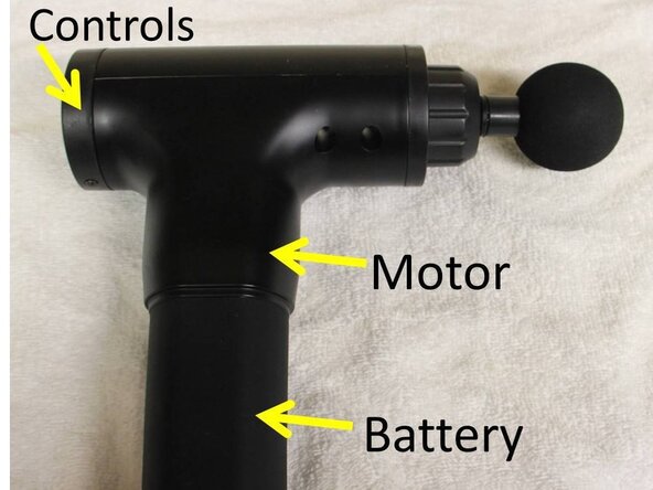

  1. Massage Gun Battery Replacement, Gun Dissasembly: 1 단계, 이미지 3개 중 1개 Massage Gun Battery Replacement, Gun Dissasembly: 1 단계, 이미지 3개 중 2개 Massage Gun Battery Replacement, Gun Dissasembly: 1 단계, 이미지 3개 중 3개
    • The rear part of the gun contains the controls.
    • Remove the screw that locks the controls lid to the gun.
    • Twist the lid to release the lid from the gun.

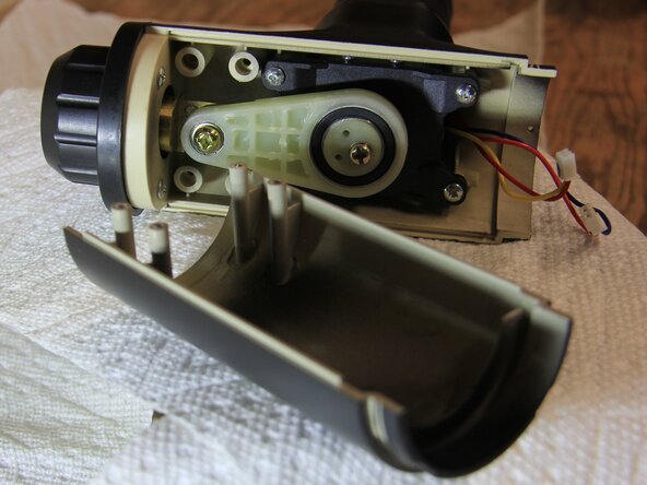

  3. Massage Gun Battery Replacement, Seperating the gun: 3 단계, 이미지 2개 중 1개 Massage Gun Battery Replacement, Seperating the gun: 3 단계, 이미지 2개 중 2개
    • Remove the screws securing the body of the gun.
    • Separate the halves of the gun body.
  4. Massage Gun Battery Replacement, Motor Removal: 4 단계, 이미지 3개 중 1개 Massage Gun Battery Replacement, Motor Removal: 4 단계, 이미지 3개 중 2개 Massage Gun Battery Replacement, Motor Removal: 4 단계, 이미지 3개 중 3개
    • Remove the bearing screw.
    • Remove the 4 screws that hold the motor to the gun.
    • Remove the motor from the gun.

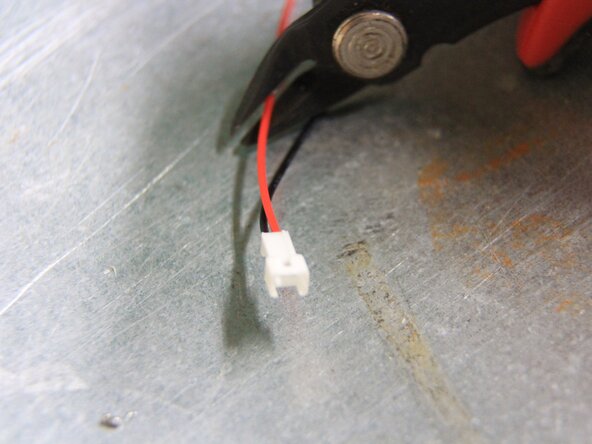

  7. Massage Gun Battery Replacement, Wire Length: 7 단계, 이미지 2개 중 1개 Massage Gun Battery Replacement, Wire Length: 7 단계, 이미지 2개 중 2개
    • The leads from the old battery were longer than the new battery.
    • Cut the new battery wires and splice a length of the old connector wire to increase the length.
    • Cut one wire at a time. If you cut through both wires simultaneously you will create a short circuit.
  8. Massage Gun Battery Replacement, Splice a Longer Wire: 8 단계, 이미지 2개 중 1개 Massage Gun Battery Replacement, Splice a Longer Wire: 8 단계, 이미지 2개 중 2개
    • Solder the wires to increase the length.
    • Insulate the spliced wires.
