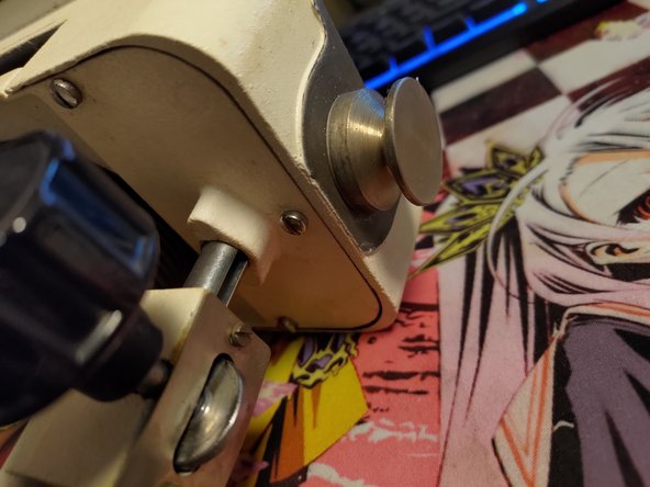

    • First remove filter so you don't accidentally damage it.
    • Remove 3 screws on the bottom. Shorter one goes to singular hole. Longer ones go to the inline holes.

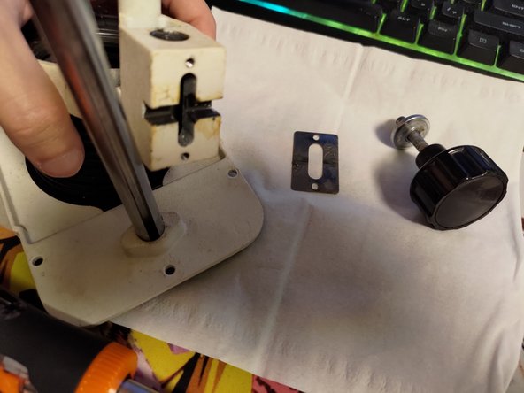

    • Remove focusing knob. Remove any oils or grime with appropriate solvent. Acetone worked for me. Be careful and always try solvents on the paint/surface where possible damage wont be noticeable.
    • Clean whole assembly in warm soapy water.
    • Dry as best as you can. Do not use blow-dryer on bellows!
    • Reapply grease and reassemble.

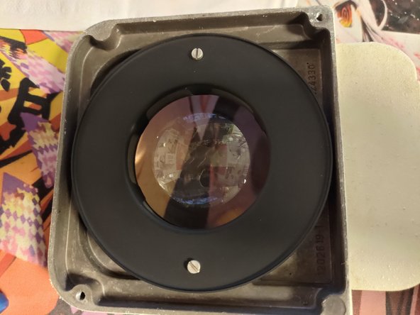

  3. Meopta Axomat 4 Disassembly, Top part: 3 단계, 이미지 3개 중 1개 Meopta Axomat 4 Disassembly, Top part: 3 단계, 이미지 3개 중 2개 Meopta Axomat 4 Disassembly, Top part: 3 단계, 이미지 3개 중 3개

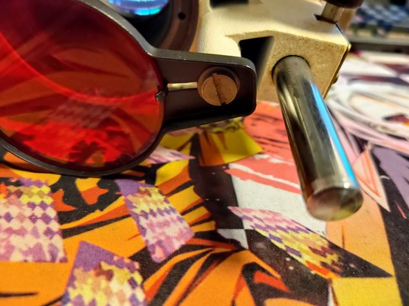

    • Remove screw and set aside glass square.
    • Unscrew two large screws and remove top housing.

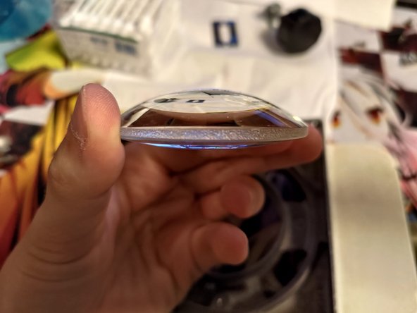

    • Remove two screws to free lens.
    • Clean metal parts in warm soapy water. Remove any residues with appropriate solvents. Be careful to not scratch/remove the mat black finish of the upper housing.
    • Clean glass parts with lens cleaning solution.
    • Reassemble.

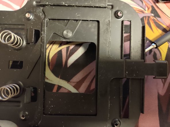

    • First remove two screws from the focusing plastic part. Careful as there are two springs under it.
    • Remove 4 screws and carefully slide bottom plate out. there are 4 metal washers/standoffs.
    • Leave "clamshell" connected.

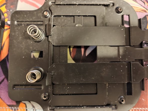

    • Remove two sliders, then the big window slider.
    • Remove grease. I used acetone again but careful as I think it could eat away the paint.
    • Clean with warm soapy water.
    • Reapply lube sparingly. Turn it upside down as some bits can be touched when in use. Apply as little as possible so you don't end up with greasy negatives.
    • Reassemble.
