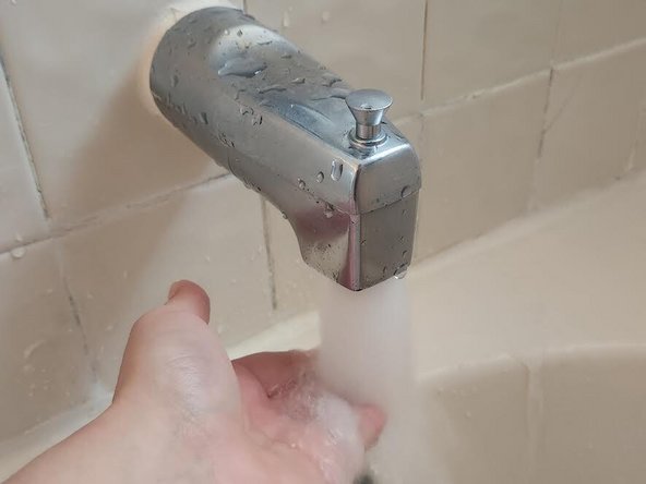

    • Open the faucet handle to relieve water pressure until there is no water flow.

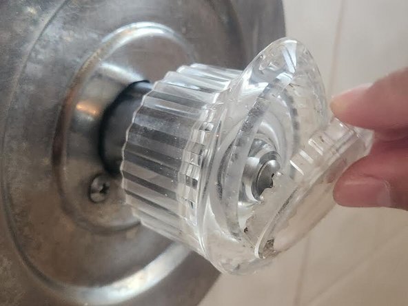

    • Remove the handle cap.
  4. Moen Single Handle Faucet Cartridge (Model: 1225) Replacement: 4 단계, 이미지 3개 중 1개 Moen Single Handle Faucet Cartridge (Model: 1225) Replacement: 4 단계, 이미지 3개 중 2개 Moen Single Handle Faucet Cartridge (Model: 1225) Replacement: 4 단계, 이미지 3개 중 3개

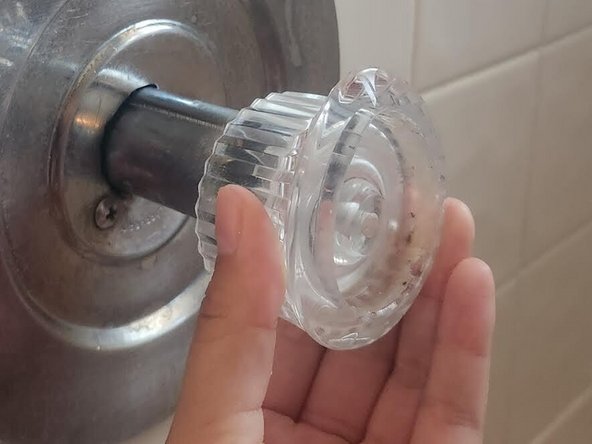

    • Use a Phillips screwdriver to unscrew the connecting handle screw (10-24 x 1-1/8" Button Head Phillips screw).
    • Remove the handle.

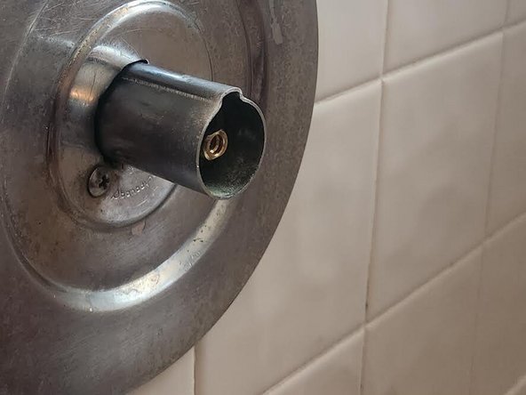

    • Pull out the stop tube.

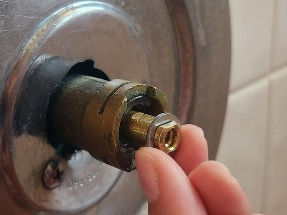

    • Remove the washer from the brass stem.

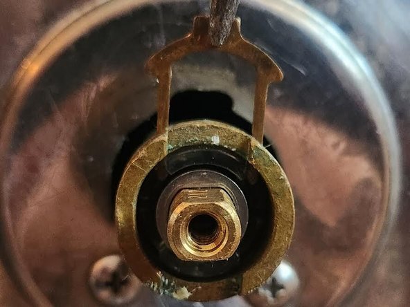

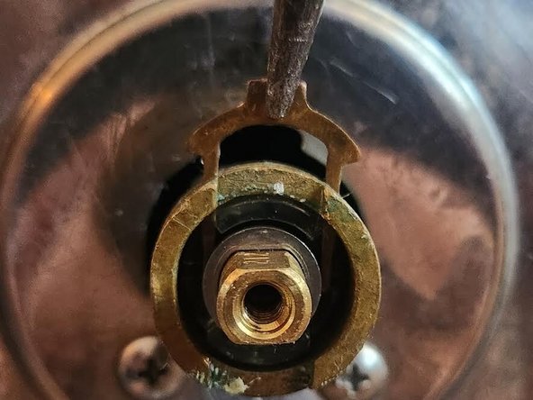

    • Using needle-nose pliers, clamp the tip of the notch of the cartridge retaining clip and pull it upwards to remove.

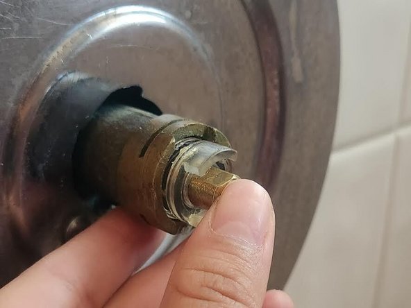

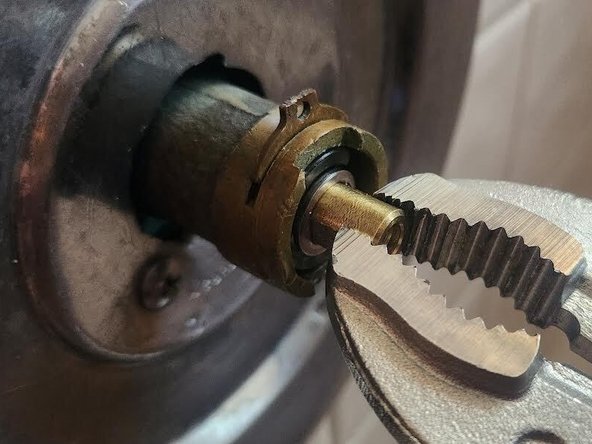

    • Using a pair of vise grips, clamp firmly onto the brass stem and pull out the old 1225 cartridge.
  9. Moen Single Handle Faucet Cartridge (Model: 1225) Replacement: 9 단계, 이미지 2개 중 1개 Moen Single Handle Faucet Cartridge (Model: 1225) Replacement: 9 단계, 이미지 2개 중 2개

    • Reinstall the cartridge retainer clip by sliding the clip into the valve.

    • Clamp the brass stem with vice grips and rotate it 90 degrees to the left, checking the water temperature for hot water.
    • From this position, rotate the brass stem 180 degrees to the right, checking the water temperature for cold water.
    • If the hot and cold operations are reversed, use vice grips to clamp onto the brass stem and rotate it 180 degrees from the original position.

    • Push the washer onto the brass stem.

    • Replace the stop tube by pushing it onto the valve.

    • Insert the handle onto the stop tube.
    • Use a Phillips screwdriver to screw in the connecting handle screw (10-24 x 1-1/8" Button Head Phillips screw).
