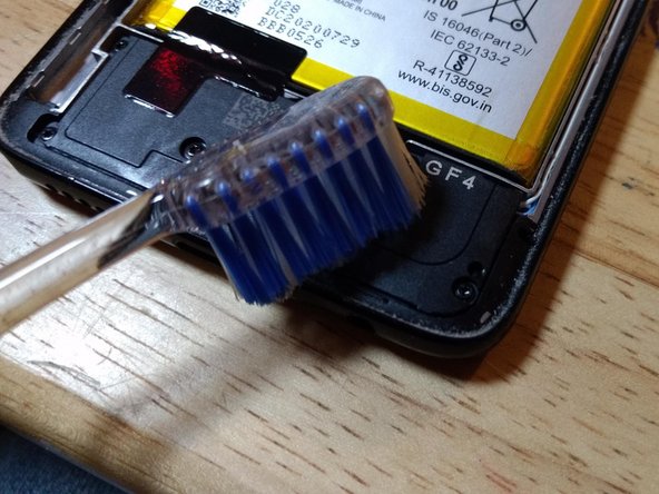

    • Now is a good time to brush away the detritus that collects in the gap during normal use, before any thing is unplugged. This will prevent it from clogging contacts.
