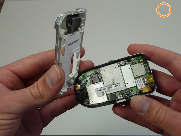

  5. Motorola V180 LCD screen and connector ribbon replacement: 5 단계, 이미지 1개 중 1개
    • The black rubber component can now easily be taken off.
  6. Motorola V180 LCD screen and connector ribbon replacement: 6 단계, 이미지 1개 중 1개

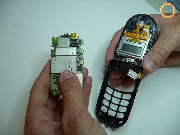

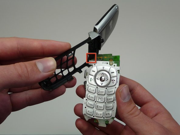

  9. Motorola V180 LCD screen and connector ribbon replacement: 9 단계, 이미지 2개 중 1개 Motorola V180 LCD screen and connector ribbon replacement: 9 단계, 이미지 2개 중 2개
    • Unclip the pronged rectangle connector ribbon attached to the motherboard.
    • Remove the motherboard.

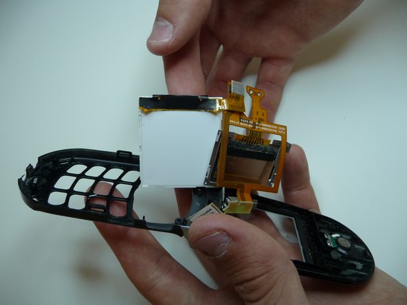

  10. Motorola V180 LCD screen and connector ribbon replacement, Screen and Connector Ribbon: 10 단계, 이미지 2개 중 1개 Motorola V180 LCD screen and connector ribbon replacement, Screen and Connector Ribbon: 10 단계, 이미지 2개 중 2개
    • Now that the connector ribbon is loose, the screen (white part) can swing away.
    • Some of the black "tape" can be peeled back, but the screen is still attached. Further work may be necessary to fully separate this part.
  11. Motorola V180 LCD screen and connector ribbon replacement: 11 단계, 이미지 2개 중 1개 Motorola V180 LCD screen and connector ribbon replacement: 11 단계, 이미지 2개 중 2개
    • Slide out the part of the connector ribbon that was just attached to the motherboard through this narrow slot in the phone.
    • This may require some effort as it is a tight fit, so proceed with caution to avoid tearing the ribbon while maneuvering it through the slot.
    • Once the connector ribbon is successfully removed from the slot, proceed to remove the entire unit from the phone.
