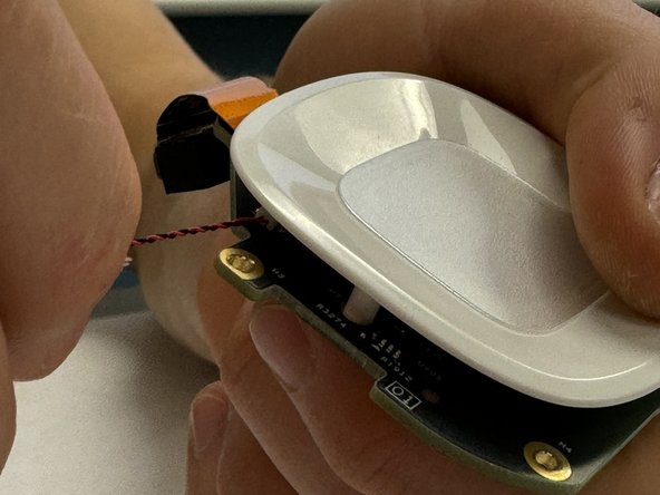

    • Remove the two screws that secure the speaker with a T3 Torx screwdriver.
  4. Nanit Pro N301 Speaker Replacement: 4 단계, 이미지 2개 중 1개 Nanit Pro N301 Speaker Replacement: 4 단계, 이미지 2개 중 2개
    • Use tweezers to disconnect the speaker motherboard connection.
    • Do not pull on the wires.
    • Remove the speaker.
