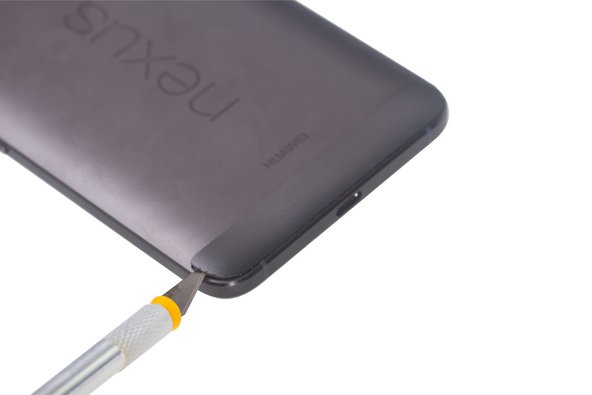

  2. Nexus 6P Daughterboard/Charging Port Replacement: 2 단계, 이미지 3개 중 1개 Nexus 6P Daughterboard/Charging Port Replacement: 2 단계, 이미지 3개 중 2개 Nexus 6P Daughterboard/Charging Port Replacement: 2 단계, 이미지 3개 중 3개
    • Heat up back glass panel.
    • Use hobby knife to open a gap and cut the fierce sticker underneath rear glass panel.
    • The back glass panel is easily shattered and the adhesive underneath is fierce. So be careful to pry this part.

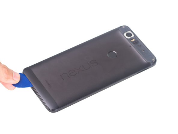

  3. Nexus 6P Daughterboard/Charging Port Replacement: 3 단계, 이미지 3개 중 1개 Nexus 6P Daughterboard/Charging Port Replacement: 3 단계, 이미지 3개 중 2개 Nexus 6P Daughterboard/Charging Port Replacement: 3 단계, 이미지 3개 중 3개
    • Heat up bottom plastic panel.
    • Use hobby knife to open a gap and insert guitar picks to cut adhesive underneath.

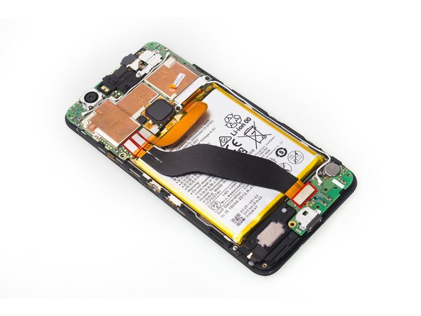

  5. Nexus 6P Daughterboard/Charging Port Replacement: 5 단계, 이미지 3개 중 1개 Nexus 6P Daughterboard/Charging Port Replacement: 5 단계, 이미지 3개 중 2개 Nexus 6P Daughterboard/Charging Port Replacement: 5 단계, 이미지 3개 중 3개
    • Unscrew one Phillips screw.
    • Remove metal bracket securing flex contactors.
    • Release 3 flex contactors and remove it .
    • This flex is used to connect motherboard and daughterboard.

To replace the daugherboard, step #5 can largely be skipped - just remove the cable from the daugherboard and move on to step #6. This phone is a true PITA to take apart.
ashlux - 답글
