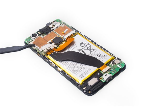

  5. Nexus 6P Teardown: 5 단계, 이미지 3개 중 1개 Nexus 6P Teardown: 5 단계, 이미지 3개 중 2개 Nexus 6P Teardown: 5 단계, 이미지 3개 중 3개
    • Unscrew one Phillips screw.
    • Remove metal bracket securing flex contactors.
    • Release 3 flex contactors and remove it .
    • This flex is used to connect motherboard and daughterboard.

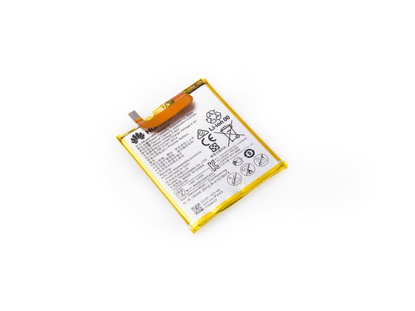

    • Release battery contactor.
    • The battery is fiercely glued in.
    • Use plastic card to cut strong adhesive underneath, then pry up and remove battery.
  7. Nexus 6P Teardown: 7 단계, 이미지 2개 중 1개 Nexus 6P Teardown: 7 단계, 이미지 2개 중 2개
    • Here we can see the strong sticker underneath 3450 mAh battery.

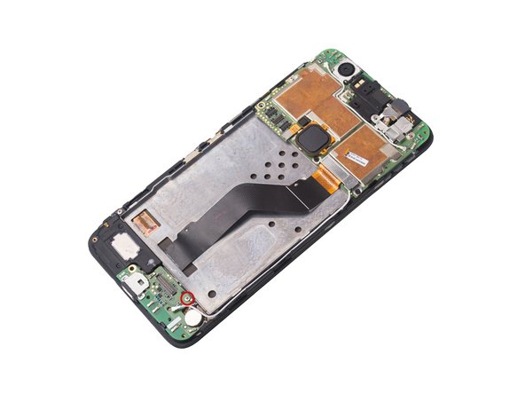

    • Disconnect signal cable contactor and twist off one Phillips screw.
    • Remove daughterboard.

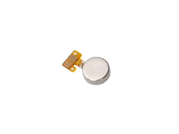

    • Cut adhesive underneath vibration motor, then remove vibrator.

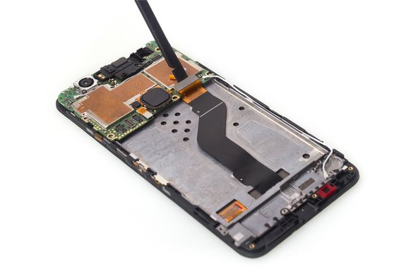

    • Pry up and remove motherboard.

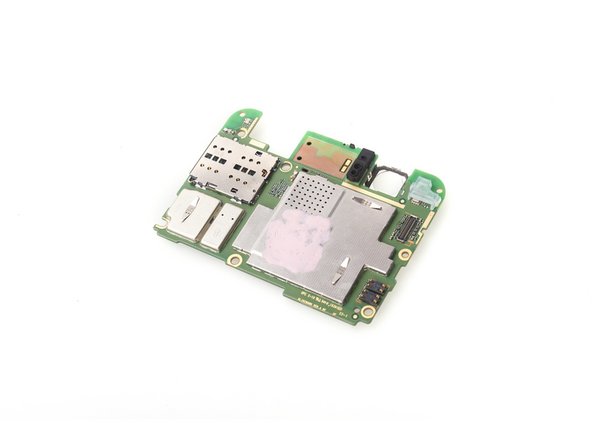

    • Here is the motherboard.

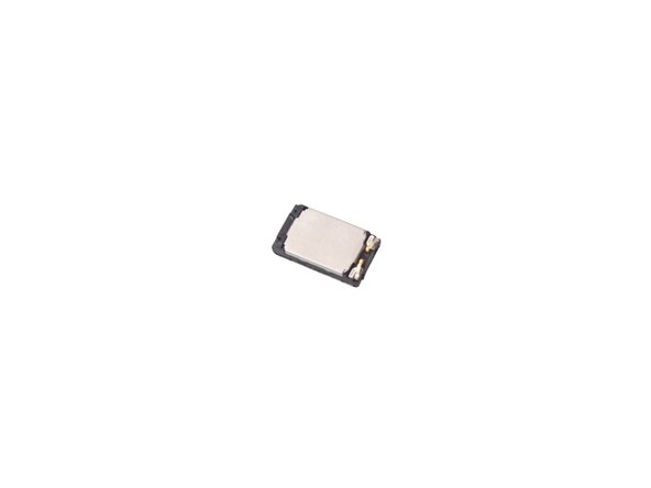

    • Remove earpiece.
