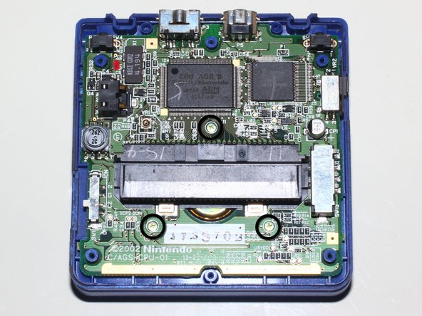

  3. Nintendo Game Boy Advance SP Buttons Replacement: 3 단계, 이미지 3개 중 1개 Nintendo Game Boy Advance SP Buttons Replacement: 3 단계, 이미지 3개 중 2개 Nintendo Game Boy Advance SP Buttons Replacement: 3 단계, 이미지 3개 중 3개
    • Back cover contains 4 Gold Tri-Wing #0 screws (Red circle), and 2 Silver Tri-Wing #0 Screws (Yellow circle).
    • Remove screws and lift back cover off giving access to motherboard.
    • Motherboard is secured by 3 Phillips #0 screws.
    • Triggers L&R (Orange box), and Power Switch Piece (Yellow box) are found affixed to the rear cover.

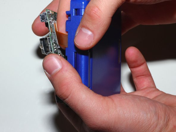

  4. Nintendo Game Boy Advance SP Buttons Replacement: 4 단계, 이미지 1개 중 1개
    • Flip the motherboard over very carefully as not to damage the display ribbon.
    • You now have access to the device speaker and buttons.
  5. Nintendo Game Boy Advance SP Buttons Replacement: 5 단계, 이미지 3개 중 1개 Nintendo Game Boy Advance SP Buttons Replacement: 5 단계, 이미지 3개 중 2개 Nintendo Game Boy Advance SP Buttons Replacement: 5 단계, 이미지 3개 중 3개
    • Carefully using fingers, detatch display ribbon from its socket. This ribbon is especially hard to remove due to the angle in which you'll need to remove it.
    • You can now access the motherboard and the input buttons freely.
