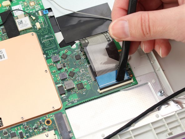

  7. One Education Infinity Keyboard Replacement: 7 단계, 이미지 3개 중 1개 One Education Infinity Keyboard Replacement: 7 단계, 이미지 3개 중 2개 One Education Infinity Keyboard Replacement: 7 단계, 이미지 3개 중 3개
    • Using a spudger, pop up the locking hinge on the wide ZIF connector in the middle of the back case on the right side of the motherboard.
    • Pull the wide ribbon cable out from the ZIF connector with your fingers.

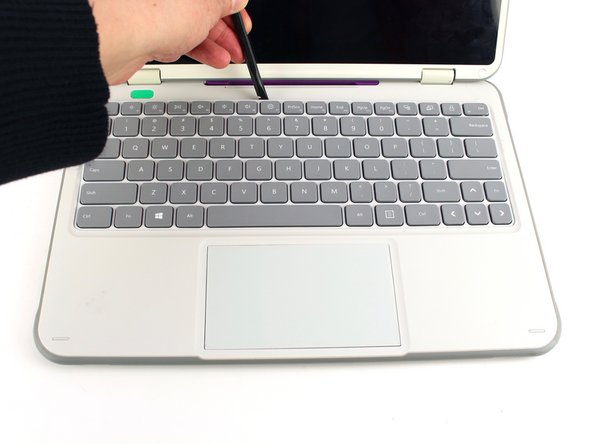

  8. One Education Infinity Keyboard Replacement: 8 단계, 이미지 3개 중 1개 One Education Infinity Keyboard Replacement: 8 단계, 이미지 3개 중 2개 One Education Infinity Keyboard Replacement: 8 단계, 이미지 3개 중 3개
    • Use a spudger to pry the keyboard up from one of the upper corners, then move the spudger along the upper edge to disconnect all of the clips on the upper side.
    • Do not remove the keyboard yet, as the ribbon cable on the backside is still held down with tape.
    • Flip the device over without allowing the keyboard clips to reengage.

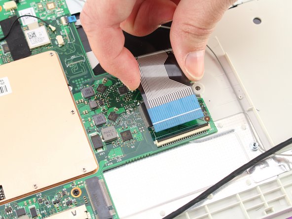

  9. One Education Infinity Keyboard Replacement: 9 단계, 이미지 3개 중 1개 One Education Infinity Keyboard Replacement: 9 단계, 이미지 3개 중 2개 One Education Infinity Keyboard Replacement: 9 단계, 이미지 3개 중 3개
    • Peel back the thick black tape holding down the keyboard ribbon cable.
    • Lift up the ribbon cable and feed it through the case as you pull the keyboard away.
    • You may need to move the tape out of the way as you insert the new keyboard ribbon cable.

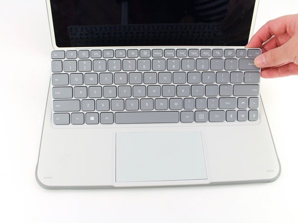

  10. One Education Infinity Keyboard Replacement: 10 단계, 이미지 2개 중 1개 One Education Infinity Keyboard Replacement: 10 단계, 이미지 2개 중 2개
    • Taking care that the ribbon cable doesn't get caught on the tape on the other side, lift the keyboard out from the upper case.
