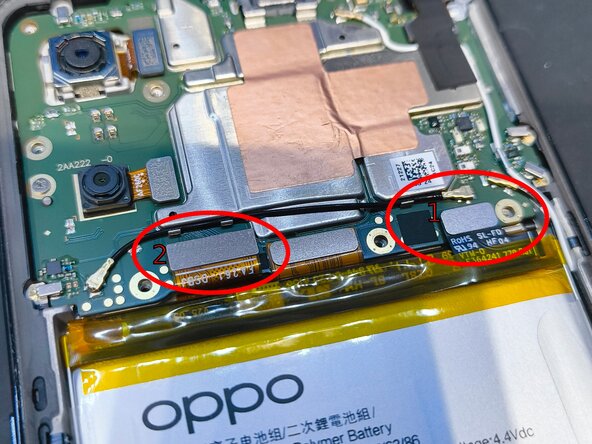

  2. Oppo A55s Screen Replacement, Disconnect battery and screen: 3 단계, 이미지 1개 중 1개
    • As with all repairs, disconnect the battery (right side) from the main board to avoid any shorting. You can gently bend it away to prevent it reconnecting during repair.
    • Disconnect the screen (left side)
    • Now is a good time to test your replacement screen works.

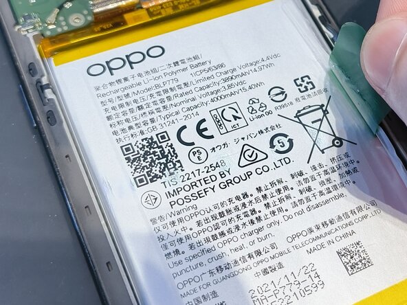

  3. Oppo A55s Screen Replacement, Remove the battery: 4 단계, 이미지 1개 중 1개
    • Pull up on the green tape on the battery with your hand to release it from the battery jacket.
    • If you're experiencing difficulty, feel free to heat the device up from the screen side. This will loosen the battery adhesive.
    • Take out the battery jacket and place it on the battery once again.
