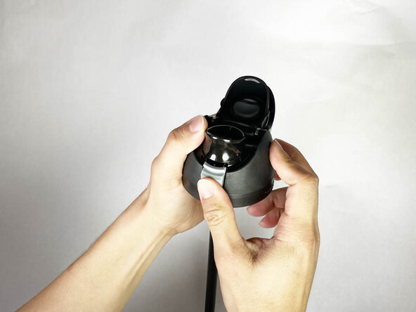

    • Empty any contents within the bottle and clean the lid area dry.

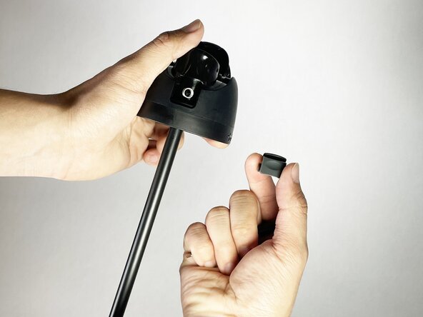

    • Insert the flathead screwdriver into the gap on either side of the button and pry it off.
    • There will be a spring underneath the button.

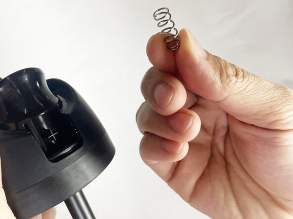

    • Remove the old spring.

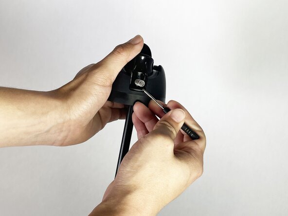

    • Put the new spring in its place.

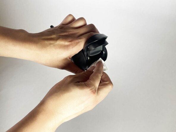

    • Place the new button on top of the spring and apply pressure until it clicks.
  6. Owala Free Sip Water Bottle Button Replacement: 6 단계, 이미지 3개 중 1개 Owala Free Sip Water Bottle Button Replacement: 6 단계, 이미지 3개 중 2개 Owala Free Sip Water Bottle Button Replacement: 6 단계, 이미지 3개 중 3개
    • Close the lid and press the button repeatedly to ensure it functions correctly.
