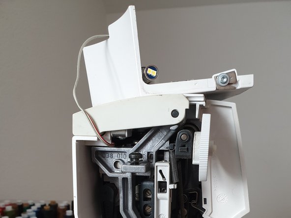

    • Open the cover as if you were opening a book.
    • The cover is not attached with a hinge (or anything else) at the back, so hold it firmly.
    • At the back runs the cable for the sewing light; be careful not to accidentally tear it off.
    • Release the cable for the sewing light from its 4 retaining clips on the inside of the cover with your fingers.
    • Place the cover on the sewing machine arm so that the cable is not strained.

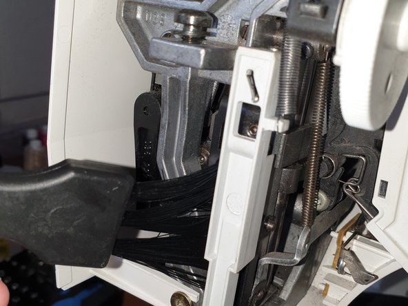

    • Use a (hand) hoover with the narrowest possible brush attachment to remove the coarsest dust.
    • If you don't have this attachment, brushing the dust into a lower placed hoover can be a viable alternative.
    • Then take a narrow cleaning brush with long bristles to clean the mechanism thoroughly from all sides.
    • The cleaning brush with long bristles from iFixit is really very well suited for this. The bristles are long and can reach everywhere, the brush is narrow so that you can also reach hidden corners easily. The bristles don't fall out, as easily happens with hair brushes, they don't scratch, but they are stable enough to remove dirt well.
    • Coarse or stuck dust particles can be fished out easily with long, narrow, pointed tweezers.
    • While cleaning, turn the handwheel and the thread tension wheel back and forth to catch as much dust as possible.

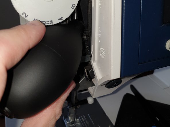

    • Then take a dust blower and blow air from different angles against the mechanism
    • The dust blower should only be used when most of the dust has already been removed. Otherwise, you risk pushing the dust even deeper into the housing.
    • Repeat these last steps, until the mechanism is clean again and there is no dust falling off or stuck inside it.

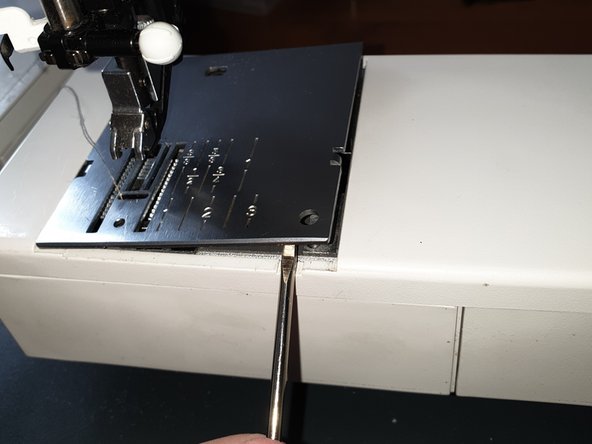

    • If you have not already done so, remove the needle, presser foot and bobbin case with the bobbin thread. Remove the sewing table.
    • The needle plate is only held by two clips. Using a flat-blade screwdriver or iFixit spudger, lift up first the right and then the left side of the needle plate to remove it.
    • Lower the feed dog by sliding the switch next to the thread cap towards the right.

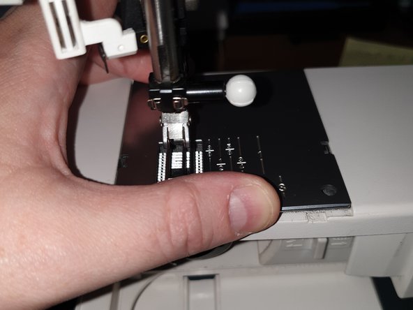

    • Put the needle plate back in place. Press it down centrally at the back and front and the clips will snap back into place.

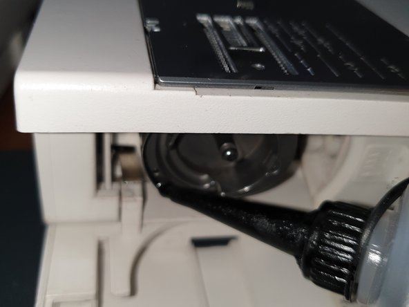

    • Now add a drop of sewing machine oil in the hook at the place marked in picture 3 and the machine will be happy again!
