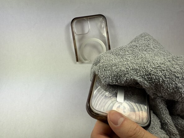

    • Clean the cracked area of your phone case with a microfiber towel.

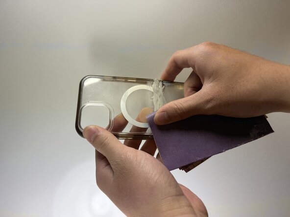

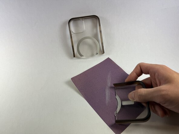

    • Sand down the area until smooth.

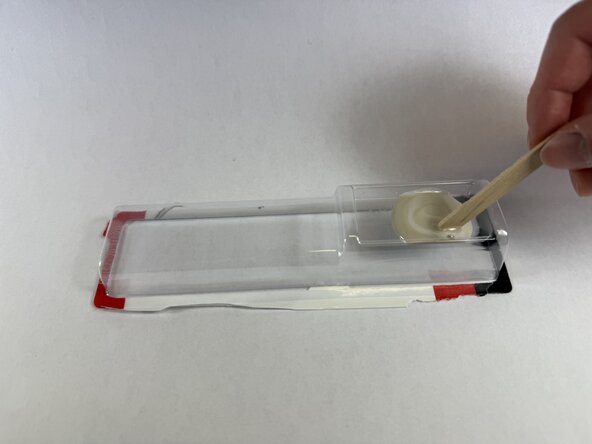

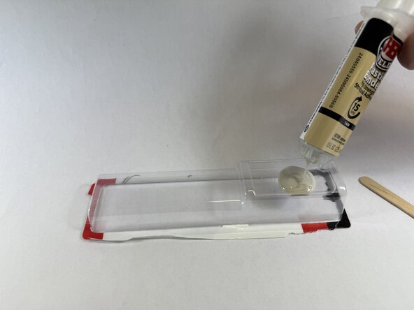

    • Inject JB Weld epoxy into the provided mixing tray or a container of choice.
    • Use a disposable stick to mix the two elements into a homogeneous solution.

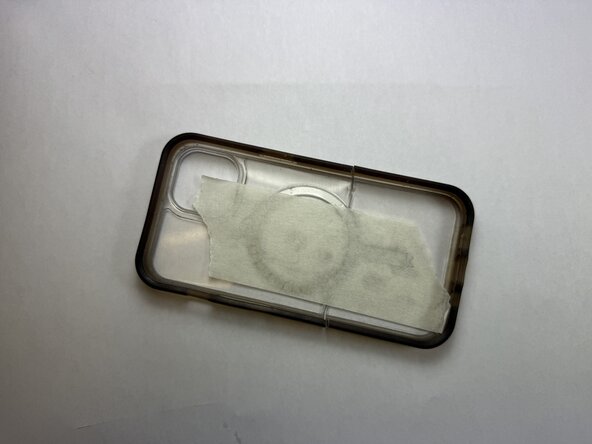

    • Use tape to hold the cracked or broken pieces firmly in place, ensuring the edges stay aligned maximizing contact.

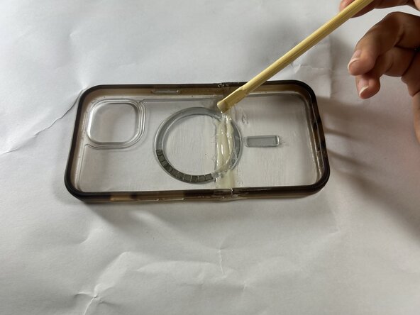

    • Grab a small stick or any disposable tool.
    • Generously apply the mixed epoxy along the crack. Make sure to get some epoxy on the internal broken edges.

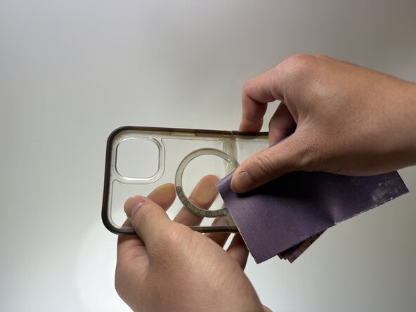

    • Wait for 30 minutes for epoxy to cure fully before sanding.
    • Sand the bonded section until smooth.
    • Repeat on the inner side of phone case.
