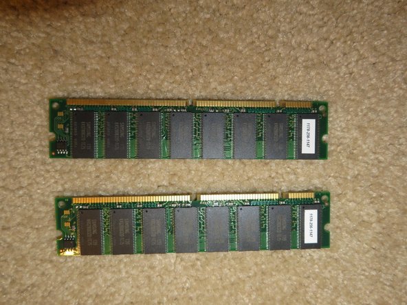

  3. Power Macintosh G3 Blue and White RAM Replacement: 3 단계, 이미지 2개 중 1개 Power Macintosh G3 Blue and White RAM Replacement: 3 단계, 이미지 2개 중 2개
    • Pull the RAM chips out of the RAM slots.
    • That's all folks! That wasn't too hard, was it?
    • Second image: RAM remains
