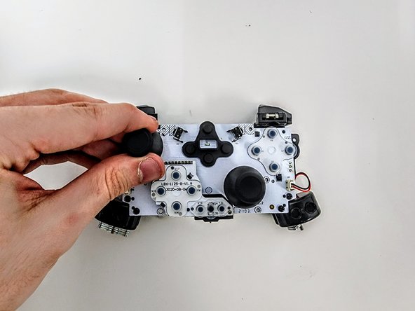

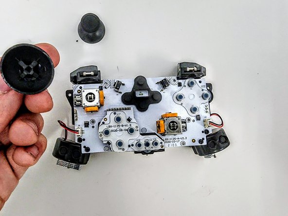

  3. PowerA Enhanced 1516953-01 Joystick Cover Replacement, Joystick Cover: 3 단계, 이미지 3개 중 1개 PowerA Enhanced 1516953-01 Joystick Cover Replacement, Joystick Cover: 3 단계, 이미지 3개 중 2개 PowerA Enhanced 1516953-01 Joystick Cover Replacement, Joystick Cover: 3 단계, 이미지 3개 중 3개
    • Firmly pinch the left joystick cover and lift it straight up and off.
    • Firmly pinch the right joystick cover and lift it straight up and off.
