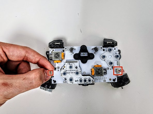

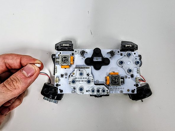

  3. PowerA Enhanced1516953-01 Vibration Motors Replacement, Vibration Motors: 3 단계, 이미지 3개 중 1개 PowerA Enhanced1516953-01 Vibration Motors Replacement, Vibration Motors: 3 단계, 이미지 3개 중 2개 PowerA Enhanced1516953-01 Vibration Motors Replacement, Vibration Motors: 3 단계, 이미지 3개 중 3개
    • Grip the white vibration motor connectors and pull them straight up and out of their sockets.
    • Do not pull on the wires.
    • Gently pull the connector from the pins

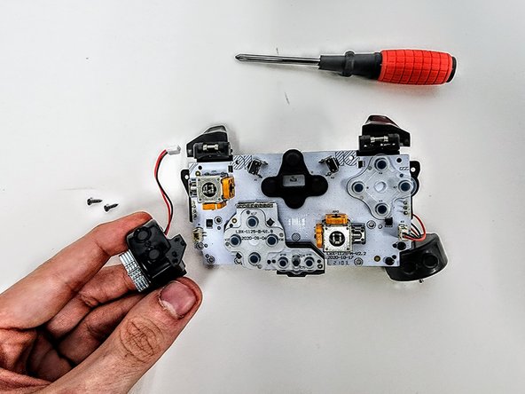

  4. PowerA Enhanced1516953-01 Vibration Motors Replacement: 4 단계, 이미지 2개 중 1개 PowerA Enhanced1516953-01 Vibration Motors Replacement: 4 단계, 이미지 2개 중 2개
    • Remove the four 3.3 mm Phillips screws that secure the motors.
    • Two screws secure each motor.
    • Once the second screw is removed on each motor, the vibration motor will immediately release itself. Support the motor while you remove the second screw.
