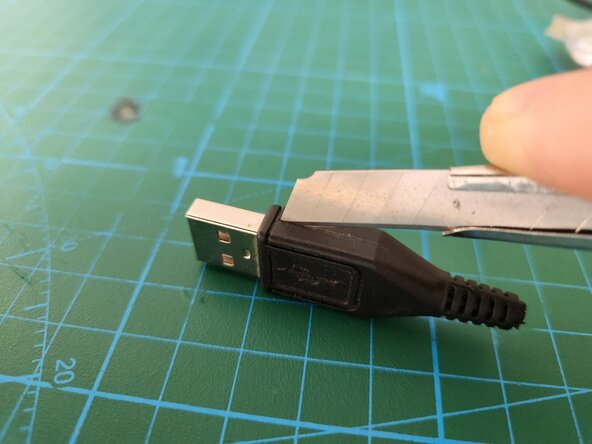

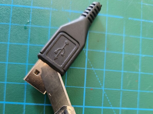

  1. Removing the USB connector from a moulded cable, Freeing the connector from the plastic: 1 단계, 이미지 3개 중 1개 Removing the USB connector from a moulded cable, Freeing the connector from the plastic: 1 단계, 이미지 3개 중 2개 Removing the USB connector from a moulded cable, Freeing the connector from the plastic: 1 단계, 이미지 3개 중 3개
    • The first step is to work on removing the moulded plastic from the metal. Start with the connecting line at the side using a utility knife. Once you completely cut the plastic from the both sides, push the utility knife between the metal and plastic as in the image to remove the plastic from the metal.

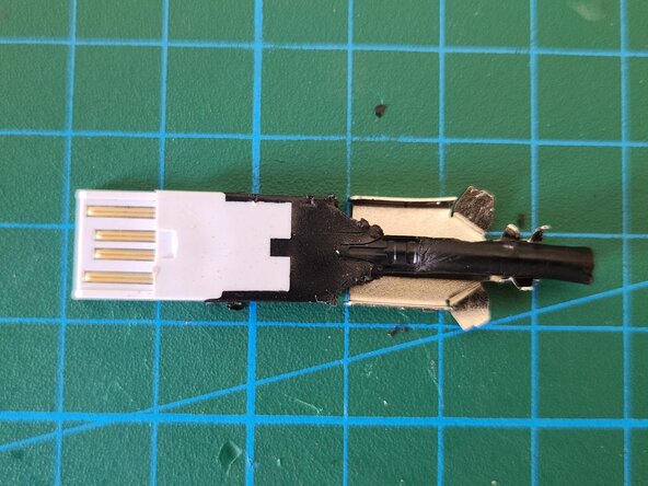

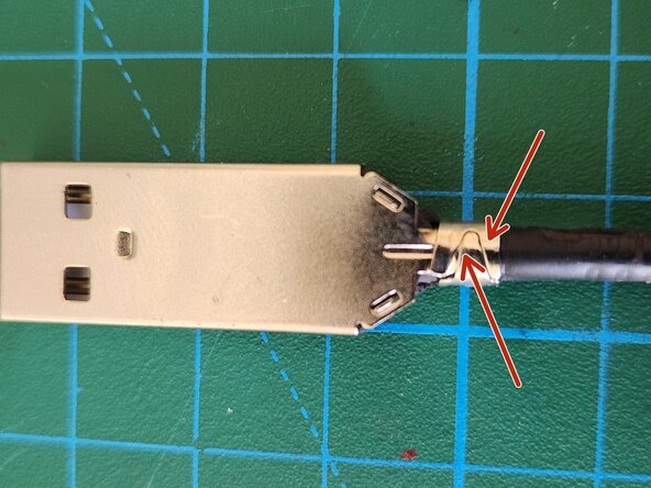

  3. Removing the USB connector from a moulded cable, Removing the fastener clips: 3 단계, 이미지 2개 중 1개 Removing the USB connector from a moulded cable, Removing the fastener clips: 3 단계, 이미지 2개 중 2개
    • Note the fastener clips that go round the cable as pointed. Remove the clips using a nose plier.

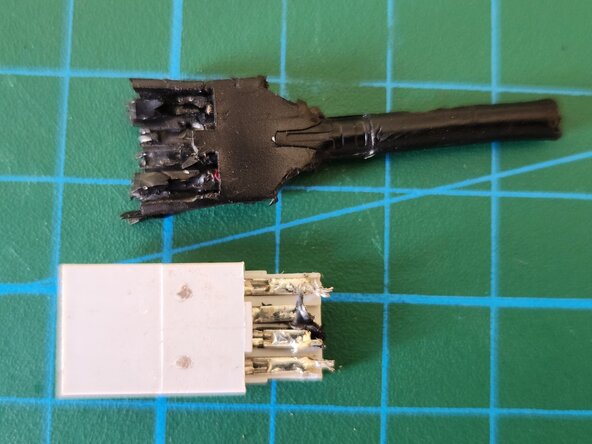

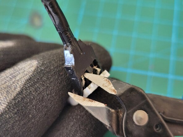

  4. Removing the USB connector from a moulded cable, Removing the plastic completely: 4 단계, 이미지 2개 중 1개 Removing the USB connector from a moulded cable, Removing the plastic completely: 4 단계, 이미지 2개 중 2개
    • In this step we completely remove the moulded plastic from the connector. Bear in mind that since the mould was hot, the plastic was in liquid form and thus dispersed throughout the connector. Remove the plastic carefully and if the plastic is stuck/stubborn, use the cable cutter to cut/remove it.

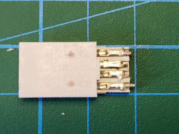

  5. Removing the USB connector from a moulded cable, Cleaning and finalizing: 5 단계, 이미지 3개 중 1개 Removing the USB connector from a moulded cable, Cleaning and finalizing: 5 단계, 이미지 3개 중 2개 Removing the USB connector from a moulded cable, Cleaning and finalizing: 5 단계, 이미지 3개 중 3개
    • Now that we dismantled our USB connector from the moulded plastic, the remaining part is to clean up the remains -if any.
    • Before adding the connector to our spare parts, the final step is to make sure that all the pins are in working order. Visually inspect the pins and recheck they all work with a connectivity test in your multimeter.

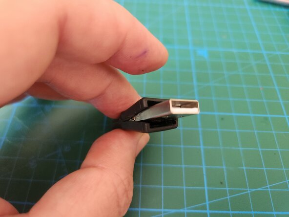

Since the cable is of moulded type, we cannot bring the cable to its initial state.
