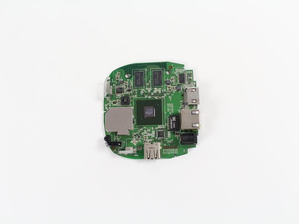

  5. Roku 3 Motherboard Replacement: 5 단계, 이미지 1개 중 1개
    • Use your fingers to carefully lift the motherboard from the top half of the device.
  6. Roku 3 Motherboard Replacement: 6 단계, 이미지 2개 중 1개 Roku 3 Motherboard Replacement: 6 단계, 이미지 2개 중 2개
    • Pull away the IO shield from the motherboard using your hands.
