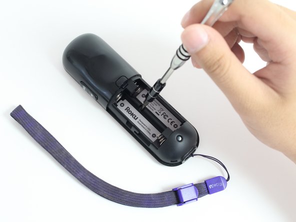

    • Unscrew one 7 mm Phillips #0 screw from the center of the battery compartment.

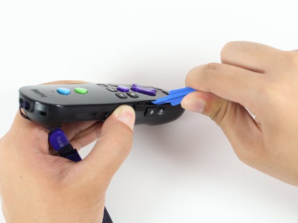

    • Gently pry open the remote using the plastic opening tool.
  6. Roku 3 Remote Control Motherboard Replacement: 6 단계, 이미지 2개 중 1개 Roku 3 Remote Control Motherboard Replacement: 6 단계, 이미지 2개 중 2개

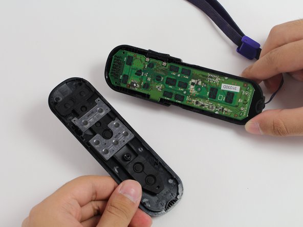

    • The remote buttons, sensors, and motherboard are not attached to anything inside the remote. Take apart the remote with caution to ensure these components do not accidentally fall out.
    • Separate the top and bottom of the remote casing.
    • Gently place each half of the remote onto a table so that the exteriors are face down.
  7. Roku 3 Remote Control Motherboard Replacement: 7 단계, 이미지 1개 중 1개
    • Set aside the half of the remote with the buttons.
    • Take the the other half of the remote with one hand and remove the motherboard with your thumb and forefinger of the other hand.
