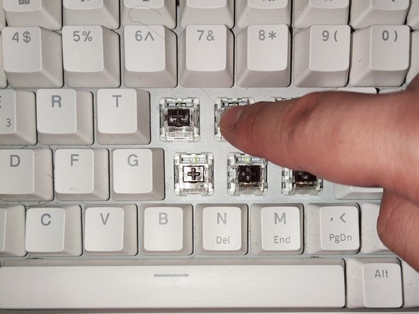

  5. Royal Kludge Rk96 Keyboard Switch Replacement: 5 단계, 이미지 3개 중 1개 Royal Kludge Rk96 Keyboard Switch Replacement: 5 단계, 이미지 3개 중 2개 Royal Kludge Rk96 Keyboard Switch Replacement: 5 단계, 이미지 3개 중 3개
    • Grab the switch using the switch puller then cautiously raise it up to unclip and remove it.

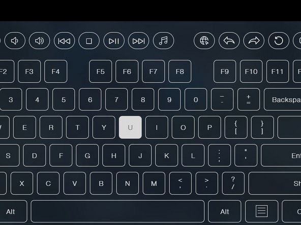

  7. Royal Kludge Rk96 Keyboard Switch Replacement: 7 단계, 이미지 3개 중 1개 Royal Kludge Rk96 Keyboard Switch Replacement: 7 단계, 이미지 3개 중 2개 Royal Kludge Rk96 Keyboard Switch Replacement: 7 단계, 이미지 3개 중 3개
    • Plug in the keyboard to the PC.
    • Push the key that was changed gently to make sure it registers properly.
    • Use any text editor such as Microsoft Word or keyboard-testing-specific software.

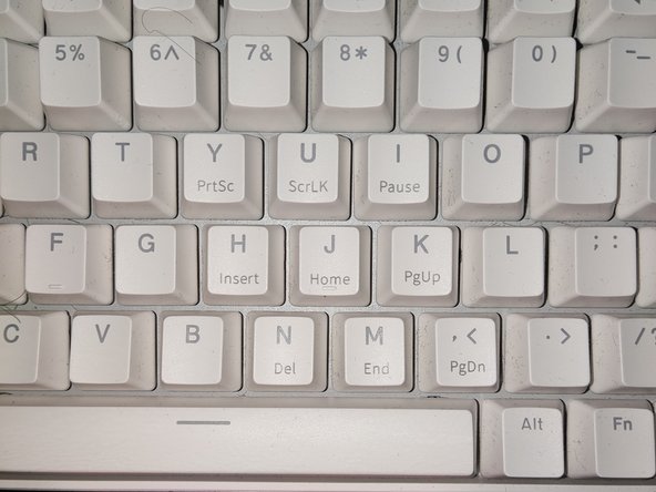

  8. Royal Kludge Rk96 Keyboard Switch Replacement: 8 단계, 이미지 3개 중 1개 Royal Kludge Rk96 Keyboard Switch Replacement: 8 단계, 이미지 3개 중 2개 Royal Kludge Rk96 Keyboard Switch Replacement: 8 단계, 이미지 3개 중 3개
    • Make sure the keycap is in line with the switch stem.
    • Depress the keycap firmly until it locks into position.
    • Make sure that the keycap is firmly positioned and fastened in line with all other keys.
