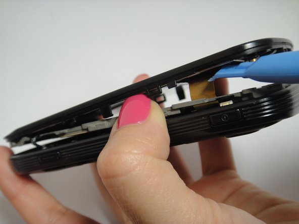

    • Use the plastic opening tool to remove the inside back cover.
    • Use the plastic opening to pry the front and the back case apart.
    • As you lift the cover, move the plastic tool around the phone to pry up all of the screen.
    • Carefully disconnect the ribbon cables and slowly lift the inside back cover to remove it.

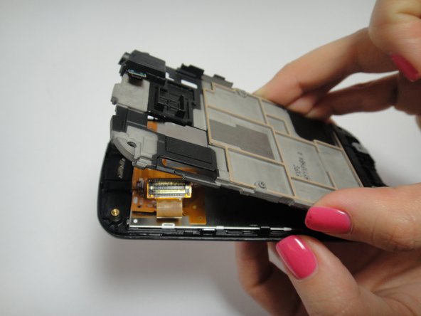

  5. Samsung Admire Screen Replacement: 5 단계, 이미지 3개 중 1개 Samsung Admire Screen Replacement: 5 단계, 이미지 3개 중 2개 Samsung Admire Screen Replacement: 5 단계, 이미지 3개 중 3개
    • Lift the motherboard slowly.
    • Carefully disconnect the volume button from the motherboard.
    • Disconnect the two ribbon cables from the back of the motherboard.

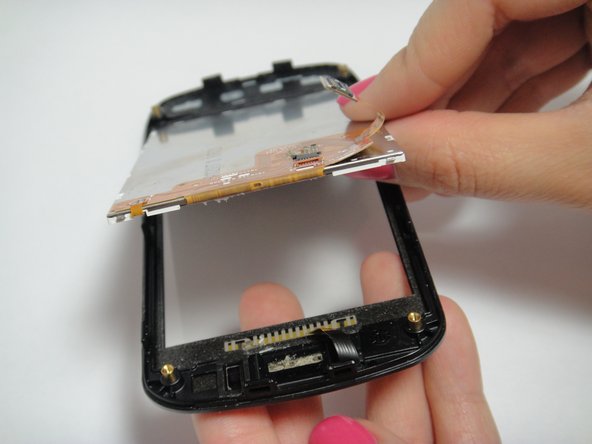

  7. Samsung Admire Screen Replacement: 7 단계, 이미지 3개 중 1개 Samsung Admire Screen Replacement: 7 단계, 이미지 3개 중 2개 Samsung Admire Screen Replacement: 7 단계, 이미지 3개 중 3개
    • Use the plastic opening tool to unlatch the ribbon cable to disconnect it.
    • Place the plastic opening tool under the edge of the screen and lift the screen up carefully.
  8. Samsung Admire Screen Replacement: 8 단계, 이미지 1개 중 1개
    • Insert new screen into the phone frame and reconnect the ribbon cable.
    • Follow steps in reverse order (omitting step eight) to reassemble the phone.
