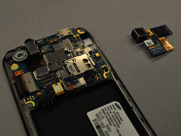

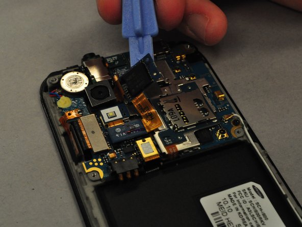

  9. Samsung Fascinate Headphone Jack/Audio Output Replacement, Camera: 9 단계, 이미지 3개 중 1개 Samsung Fascinate Headphone Jack/Audio Output Replacement, Camera: 9 단계, 이미지 3개 중 2개 Samsung Fascinate Headphone Jack/Audio Output Replacement, Camera: 9 단계, 이미지 3개 중 3개
    • Using the plastic opening tool, you will need to detach the black square component which is boxed in blue.
    • Pry camera unit attached to it off the motherboard.

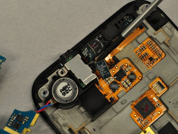

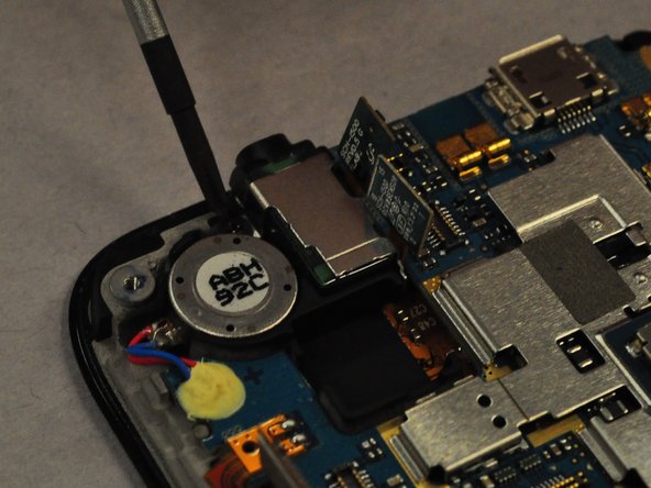

  10. Samsung Fascinate Headphone Jack/Audio Output Replacement, Headphone Jack/Audio Output: 10 단계, 이미지 3개 중 1개 Samsung Fascinate Headphone Jack/Audio Output Replacement, Headphone Jack/Audio Output: 10 단계, 이미지 3개 중 2개 Samsung Fascinate Headphone Jack/Audio Output Replacement, Headphone Jack/Audio Output: 10 단계, 이미지 3개 중 3개
    • Using the plastic opening tool, detach the green square components attaching the Audio Output device to the motherboard.
    • Now use the screwdriver to unscrew the 2 black screws holding the Audio Output device to the motherboard.

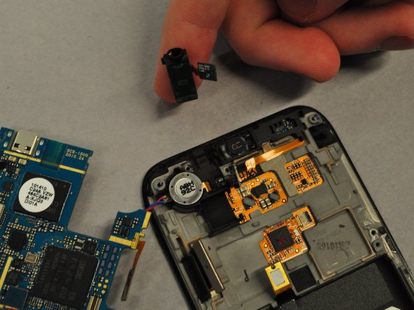

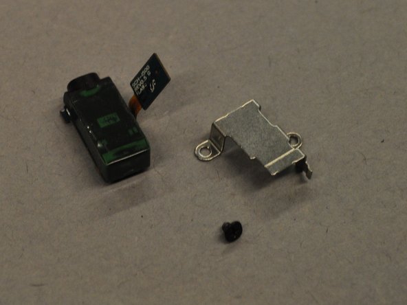

  11. Samsung Fascinate Headphone Jack/Audio Output Replacement: 11 단계, 이미지 3개 중 1개 Samsung Fascinate Headphone Jack/Audio Output Replacement: 11 단계, 이미지 3개 중 2개 Samsung Fascinate Headphone Jack/Audio Output Replacement: 11 단계, 이미지 3개 중 3개
    • Now that you have unscrewed the 2 black screws, the silver plate holding the device to the motherboard should come right off.
    • Next, gently pull the Audio Output device off of the LCD touchscreen. It is secured by some weak adhesive and should come off easily.
    • You are now free to install a new Headphone Jack/Audio Output device.
