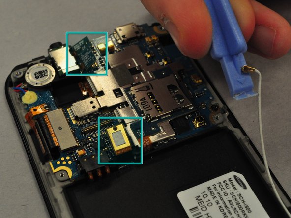

  10. Samsung Fascinate Motherboard Replacement, Motherboard: 10 단계, 이미지 3개 중 1개 Samsung Fascinate Motherboard Replacement, Motherboard: 10 단계, 이미지 3개 중 2개 Samsung Fascinate Motherboard Replacement, Motherboard: 10 단계, 이미지 3개 중 3개
    • Use the plastic opening tool to disconnect the white wire boxed in red.
    • Carefully disconnect the green and golden boxed components from the motherboard.
    • The boxed components do not completely detached from the motherboard.

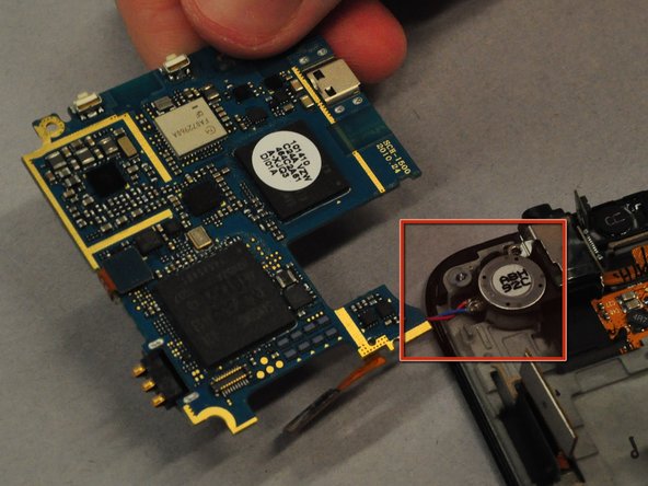

  11. Samsung Fascinate Motherboard Replacement: 11 단계, 이미지 3개 중 1개 Samsung Fascinate Motherboard Replacement: 11 단계, 이미지 3개 중 2개 Samsung Fascinate Motherboard Replacement: 11 단계, 이미지 3개 중 3개
    • Use the screwdriver to remove the black screw circled in blue.
    • Lift the motherboard off of the touchscreen.
    • The motherboard is still attached to the phone by wires. Do not pull on the wires.

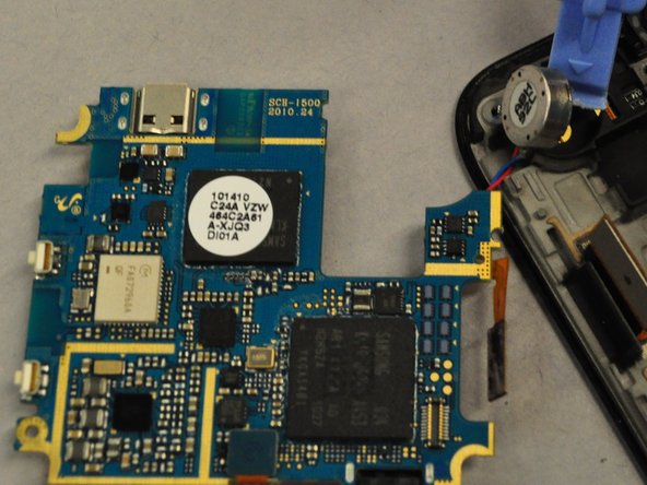

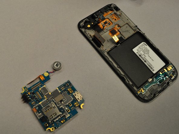

  12. Samsung Fascinate Motherboard Replacement: 12 단계, 이미지 3개 중 1개 Samsung Fascinate Motherboard Replacement: 12 단계, 이미지 3개 중 2개 Samsung Fascinate Motherboard Replacement: 12 단계, 이미지 3개 중 3개
    • Using the plastic opening tool, gently pry the silver cylinder out of its housing.
    • The cylinder is held in place by a weak adhesive and shouldn't be too difficult to remove.
