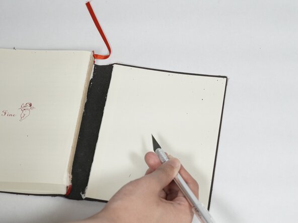

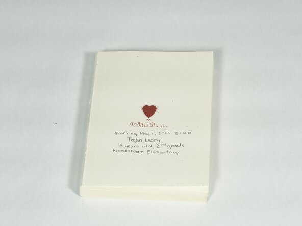

  2. Soft Leather Journal Cover Replacement: 2 단계, 이미지 3개 중 1개 Soft Leather Journal Cover Replacement: 2 단계, 이미지 3개 중 2개 Soft Leather Journal Cover Replacement: 2 단계, 이미지 3개 중 3개
    • Cut the cover and spine off from the main journal body with an X-ACTO knife.
    • Keep the main block of pages intact.
    • Save the cover for Step 5.

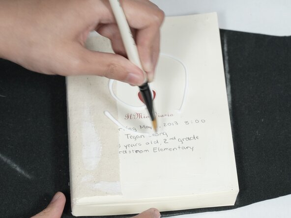

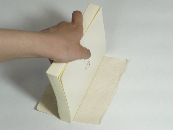

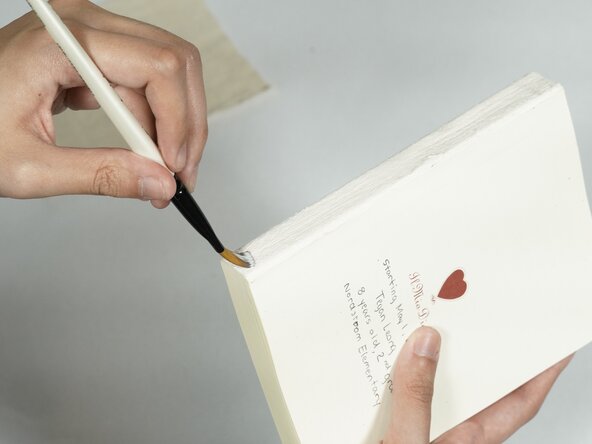

  5. Soft Leather Journal Cover Replacement: 5 단계, 이미지 3개 중 1개 Soft Leather Journal Cover Replacement: 5 단계, 이미지 3개 중 2개 Soft Leather Journal Cover Replacement: 5 단계, 이미지 3개 중 3개
    • Apply a thin layer of PVA glue to the spine of the journal with a paintbrush.
    • Press the spine firmly into the center of the stiff fabric for one minute.
    • PVA glue dries fast, so work quickly.

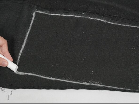

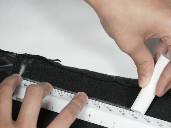

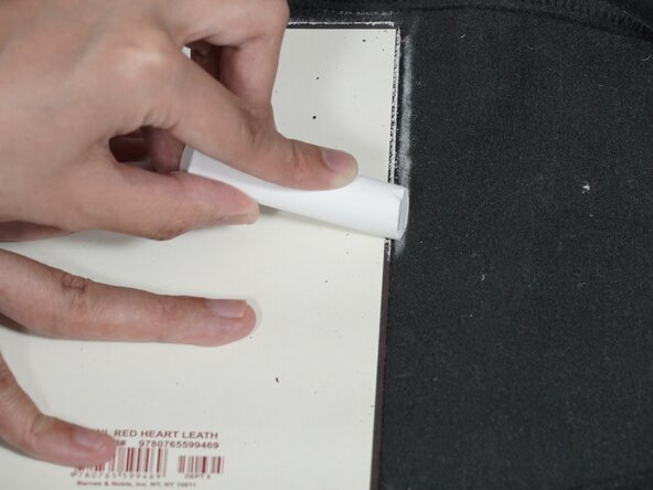

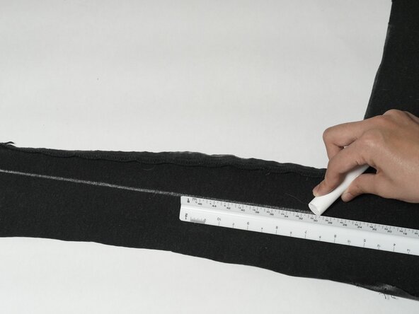

  6. Soft Leather Journal Cover Replacement: 6 단계, 이미지 3개 중 1개 Soft Leather Journal Cover Replacement: 6 단계, 이미지 3개 중 2개 Soft Leather Journal Cover Replacement: 6 단계, 이미지 3개 중 3개
    • Create the new cover:
    • Press the original cover flat onto the interior of your scrap leather.
    • Trace around the original cover with chalk.
  7. Soft Leather Journal Cover Replacement: 7 단계, 이미지 3개 중 1개 Soft Leather Journal Cover Replacement: 7 단계, 이미지 3개 중 2개 Soft Leather Journal Cover Replacement: 7 단계, 이미지 3개 중 3개
    • Cut on the chalk outline with scissors, extending the length beyond the right side by four inches.
    • This extra length will become the cover flap.

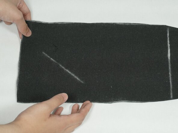

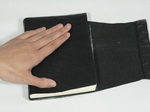

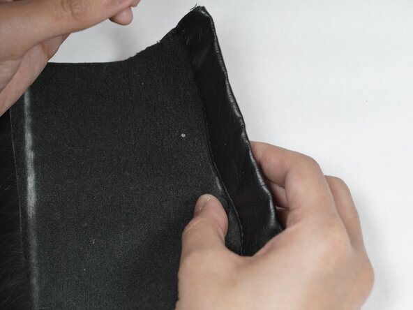

  8. Soft Leather Journal Cover Replacement: 8 단계, 이미지 3개 중 1개 Soft Leather Journal Cover Replacement: 8 단계, 이미지 3개 중 2개 Soft Leather Journal Cover Replacement: 8 단계, 이미지 3개 중 3개
    • Roll the journal onto the new cover to ensure a correct fit.
  9. Soft Leather Journal Cover Replacement: 9 단계, 이미지 2개 중 1개 Soft Leather Journal Cover Replacement: 9 단계, 이미지 2개 중 2개
    • Spread a thin, even layer of PVA glue onto the front and back of the journal.
    • Make sure to coat the overhang of the stiff fabric, but DO NOT glue the spine.

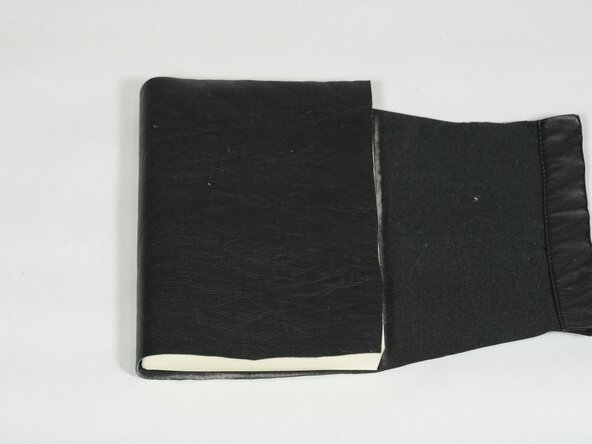

  10. Soft Leather Journal Cover Replacement: 10 단계, 이미지 3개 중 1개 Soft Leather Journal Cover Replacement: 10 단계, 이미지 3개 중 2개 Soft Leather Journal Cover Replacement: 10 단계, 이미지 3개 중 3개
    • Left align the journal (front-side down) onto the interior of your new cover, spine facing towards the center.
    • Gently roll the journal onto its back sheet until it meets the chalk line.
    • Place a weight on top of the journal for at least 30 minutes.

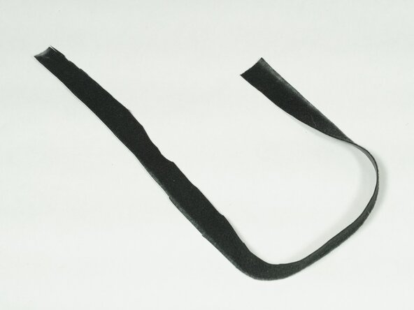

  11. Soft Leather Journal Cover Replacement: 11 단계, 이미지 3개 중 1개 Soft Leather Journal Cover Replacement: 11 단계, 이미지 3개 중 2개 Soft Leather Journal Cover Replacement: 11 단계, 이미지 3개 중 3개
    • Create the string closure:
    • Trace an 18-inch long by half-inch tall rectangle onto the interior of your excess scrap leather.
  12. Soft Leather Journal Cover Replacement: 12 단계, 이미지 2개 중 1개 Soft Leather Journal Cover Replacement: 12 단계, 이미지 2개 중 2개
    • Cut on the chalk outline.

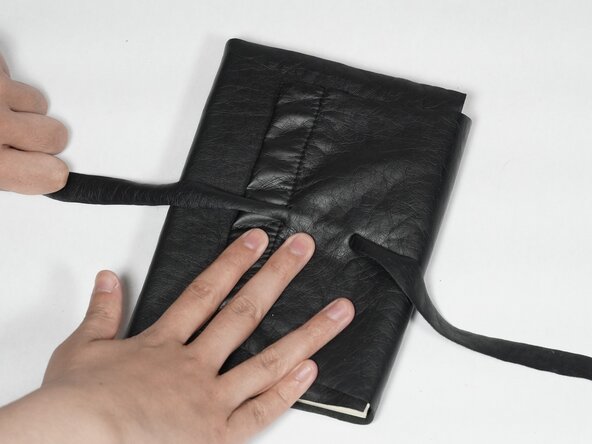

  14. Soft Leather Journal Cover Replacement: 14 단계, 이미지 3개 중 1개 Soft Leather Journal Cover Replacement: 14 단계, 이미지 3개 중 2개 Soft Leather Journal Cover Replacement: 14 단계, 이미지 3개 중 3개
    • Thread the string closure through the slits so that the ends sit on top of the cover flap.
    • Pull until two inches remain on the left side.
    • Gently tie the journal closed.

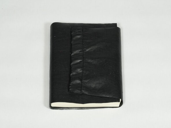

  15. Soft Leather Journal Cover Replacement: 15 단계, 이미지 1개 중 1개
    • Congratulations! Your new journal is ready to use.
