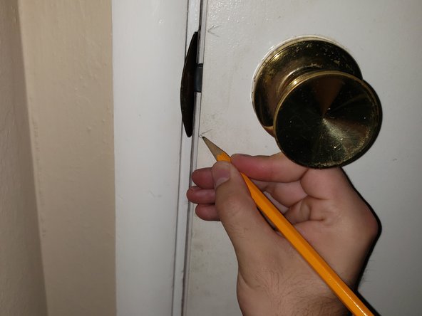

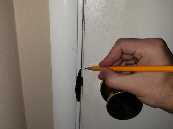

    • Mark where the light stops and starts using a pencil.
    • If there is door hardware in the way (hinges, deadbolts, etc.) like in this example, make sure to "skip over" the hardware with the gap tape. This should be reflected in your markings.
