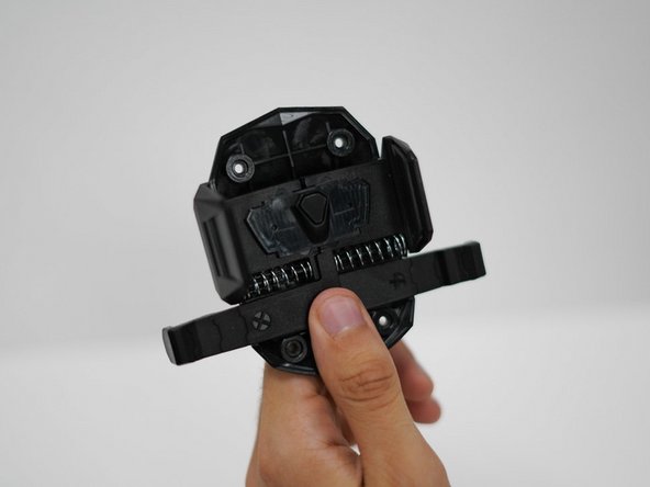

    • Remove four 5.0 mm screws from the backing panel of the phone holder using the Oval shape screwhead. Push out wing panels to release the mechanism, and remove the screws and holder from the backing panel.
  3. Spigen Kuel TS36 Car Mount Spring Replacement: 3 단계, 이미지 2개 중 1개 Spigen Kuel TS36 Car Mount Spring Replacement: 3 단계, 이미지 2개 중 2개
    • If either of the springs have not ejected from their slots, proceed to pull them out gently so that the chassis the wing panels are connected to remain undisturbed.
  4. Spigen Kuel TS36 Car Mount Spring Replacement: 4 단계, 이미지 2개 중 1개 Spigen Kuel TS36 Car Mount Spring Replacement: 4 단계, 이미지 2개 중 2개
    • Insert two new 2.6 cm springs as you would batteries to a tv remote. Be cautious as to keep the chassis in place during this process.

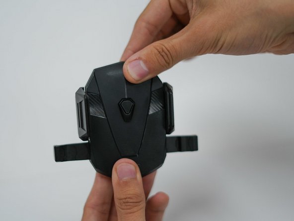

  6. Spigen Kuel TS36 Car Mount Spring Replacement: 6 단계, 이미지 2개 중 1개 Spigen Kuel TS36 Car Mount Spring Replacement: 6 단계, 이미지 2개 중 2개
    • Slide the backing panel over the frame of the holder, aligning the sides. Press the button on the center of the holder to once again disengage the mechanism. This will allow the panel to fully slide back into place.

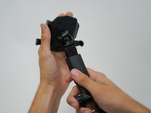

  8. Spigen Kuel TS36 Car Mount Spring Replacement: 8 단계, 이미지 2개 중 1개 Spigen Kuel TS36 Car Mount Spring Replacement: 8 단계, 이미지 2개 중 2개
    • With moderate to heavy force, apply pressure to the ball joint into the socket.
