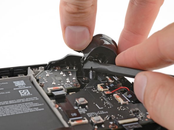

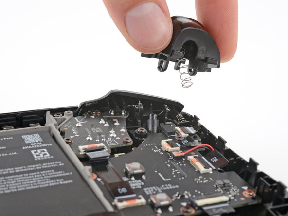

  11. Steam Deck OLED Left Trigger Replacement, Remove the left trigger: 11 단계, 이미지 3개 중 1개 Steam Deck OLED Left Trigger Replacement, Remove the left trigger: 11 단계, 이미지 3개 중 2개 Steam Deck OLED Left Trigger Replacement, Remove the left trigger: 11 단계, 이미지 3개 중 3개
    • The left trigger is on your right-hand side when working on the Steam Deck OLED, as it's laying upside down.
    • The trigger clips into place on two pegs on the frame, which double as the hinge.
    • Place the flat end of a spudger onto the inside edge of the trigger's left clip.
    • Use your fingers to push the trigger toward the left as you wedge the spudger between the clip and the peg.
    • Use your spudger to pivot the trigger clip out, away, and up from the peg to unlatch it.
    • During reassembly, latch the right peg first. Once in place, push down on the trigger to latch the left peg, producing an audible "click" sound.
    • Check to make sure that the trigger spring is properly aligned. Test the trigger action before continuing reassembly.
